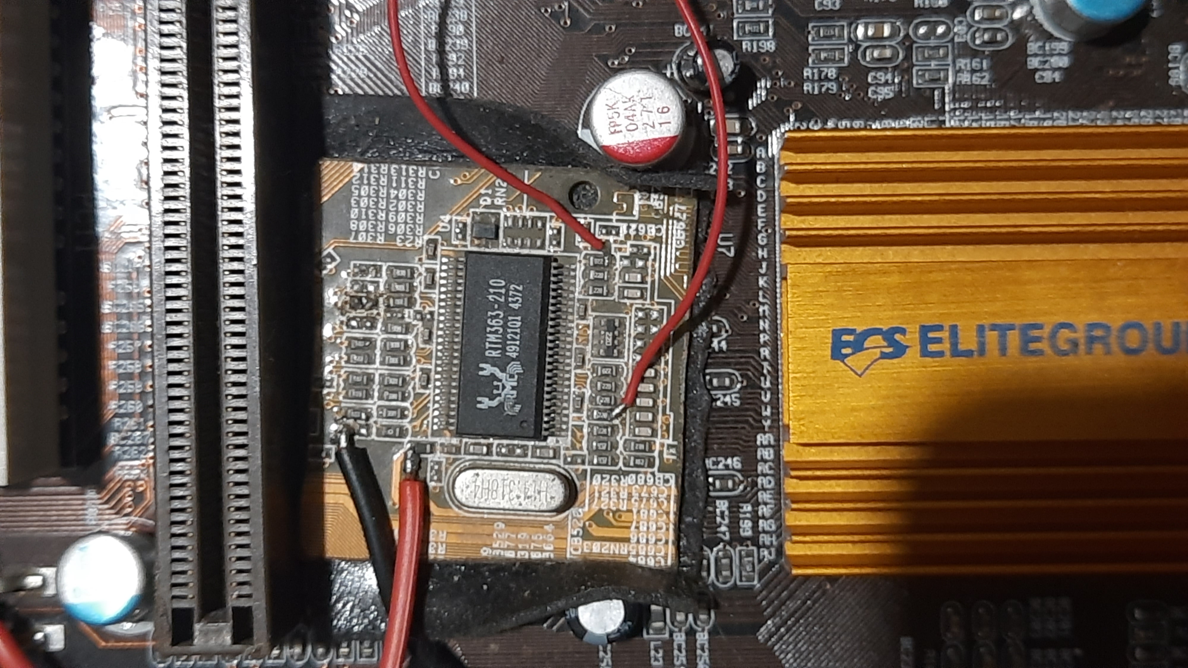

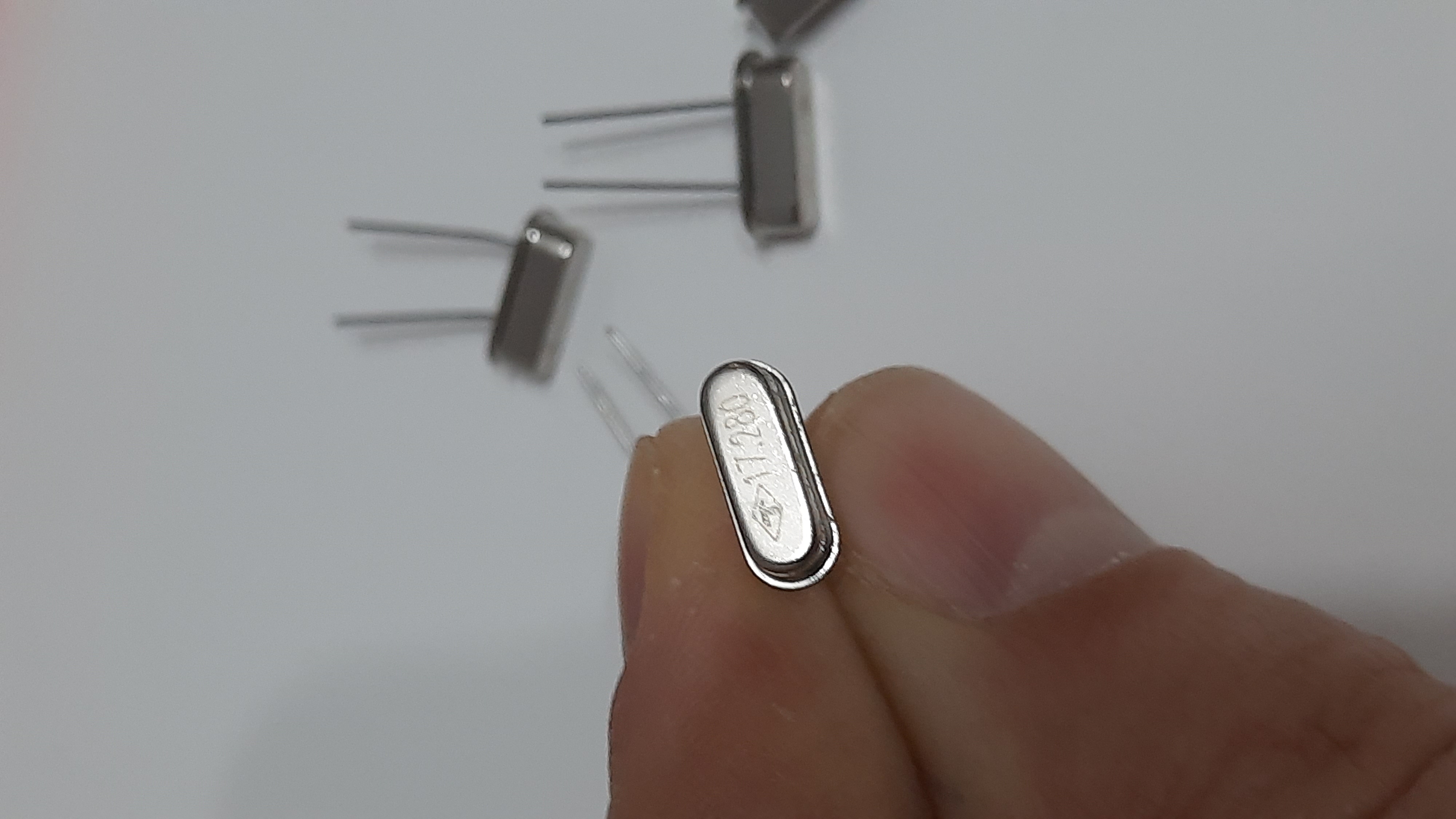

After I got the mobos back to me with the modifications, I tried to reach 203 MHz clock speed with my own DDR RAMs myself. Unfortunately, despite many attempts, I've managed to enter BIOS at most or run MemTest for a few seconds - https://u.cubeupload.com/roksana/20241205180957.jpg . I used Pentium III-S 1133 (SL6BY) for RAM selection, which does not even require additional voltage. I tested over 150 different DDR1 sticks - so far none of them allowed me to enter Windows at 203 MHz... (TerraRaptor used his own stick by APACER)
Since 200 MHz option doesn't currently work as I expected, I was forced to lower the FSB a little bit... The BIOS for 200 MHz is not ready yet anyway and it's very difficult to find a RAM stick that will run stable at 200 MHz 😉 TerraRaptor installed a higher clocked crystal oscillator to force the 203 MHz FSB speed. Setting 166 MHz in the BIOS, would make the board actually run at 203 MHz. The 150 MHZ option in the BIOS gave 183 MHz as a result. Here, at 183 MHz it was much easier for me to select a stable memory stick. Unfortunately, none of my fastest SL6BY CPUs will go that high with air cooling, but 181 MHz was within my reach 😉 In addition, 181 MHz gives a perfect CPU clock speed of 1900 MHz and I like round numbers 😁
All I had to do was to solder a lower clocked crystal oscillator. After doing that, the board overclocks perfectly to 201 MHz (166 MHz option in BIOS) or 181 (150 MHz option)
Now the dividers look like this:
I know it's not perfect in this shape... It's not what I dreamed of... but at least at 181 MHz the PCI port has only 36.2 MHz, and the AGP port runs at around 72.4 MHz. I think that 10% overclocked bus will still allow me for the installation of most of the graphics cards I would like to test on this set 😉
The problem after replacing the crystal is that the board will not display the real frequency values on the screen... In order to see the actual values you need to use an additional clockgenerator from another board 😁 This is a bit of black magic to me (you know I suck at electronics, don't you?)... so I don't know exactly how it works... but it looks like this:

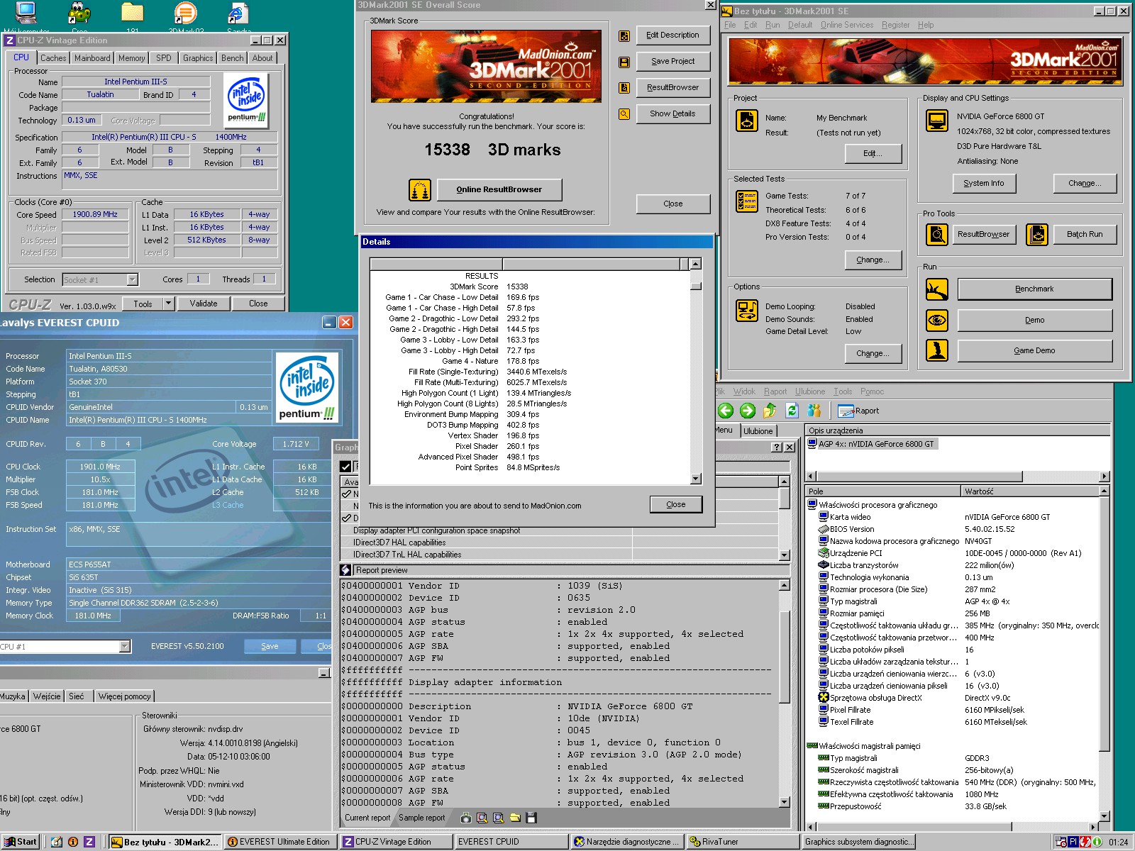

1900 MHZ and 181 MHZ bus!!!!
After a long search I got a Pentium III-S 1400 MHz (SL6BY) that runs stable at 182 MHz at 1.712Vcore. It is important for the processor not to exceed 45 Celsius degrees - because then I get crashes. Room temperature is around 22 degrees, computer environment ranges from 24 to 28 degrees. The processor temperature is currently 41/42 at idle and 44 under maximum load for several hours (unfortunately this Winbond sensor is going crazy on ECS and shows wrong values...):
Now, I am finally sure that this configuration is 100% STABLE AND NOTHING CAN BEAT IT (apart from extreme heat in the summertime 😜)
https://youtu.be/a_t52EwdxTw - My video after 3 hours of excessive stability tests 😉
Interestingly, this configuration heats up MUCH LESS than the same configuration with a different board - ASUS TUSL2C (MOSFETs get very high on ASUS while on ECS they do not exceed 60 degrees)... - https://youtu.be/YGDogB2ueoc ; https://youtu.be/SnS8KYfv7fg - on TUSL the MOSFETs exceded 100 degrees...
From all the DDR memories I have selected only 6 pieces run, more or less, stable at 181 MHz FSB. The timings are always the liimt... Only one stick runs at CL2.5-2-2-6 (even CL2.5-2-2-5) it is a 512 MB stick (from Corsair, surprisingly...) and it is a bit slower than the 1GB from GoodRam with CL2.5-2-3-6 😀

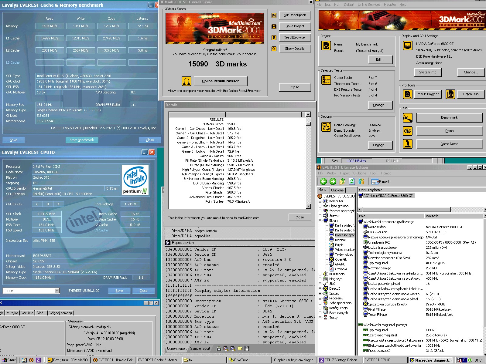

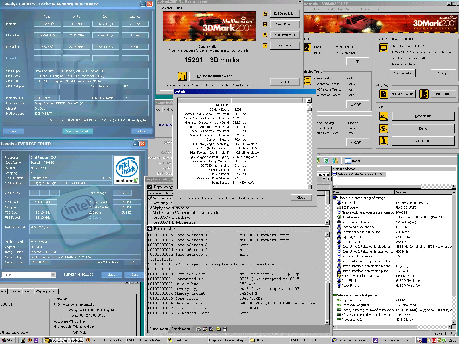

=====================================183 MHZ i 1740 CPU CLOCK=====================================
Ti 4600 1 GB GOODRAM
2001se:
https://u.cubeupload.com/roksana/4652001se.jpg
2000mark
https://u.cubeupload.com/roksana/2002i2000.jpg
stability test:
https://u.cubeupload.com/roksana/1Goodramwielkitest.jpg
sisoft:
https://u.cubeupload.com/roksana/42fsisoft.jpg
other:
https://u.cubeupload.com/roksana/wprimeandsuperpi.jpg

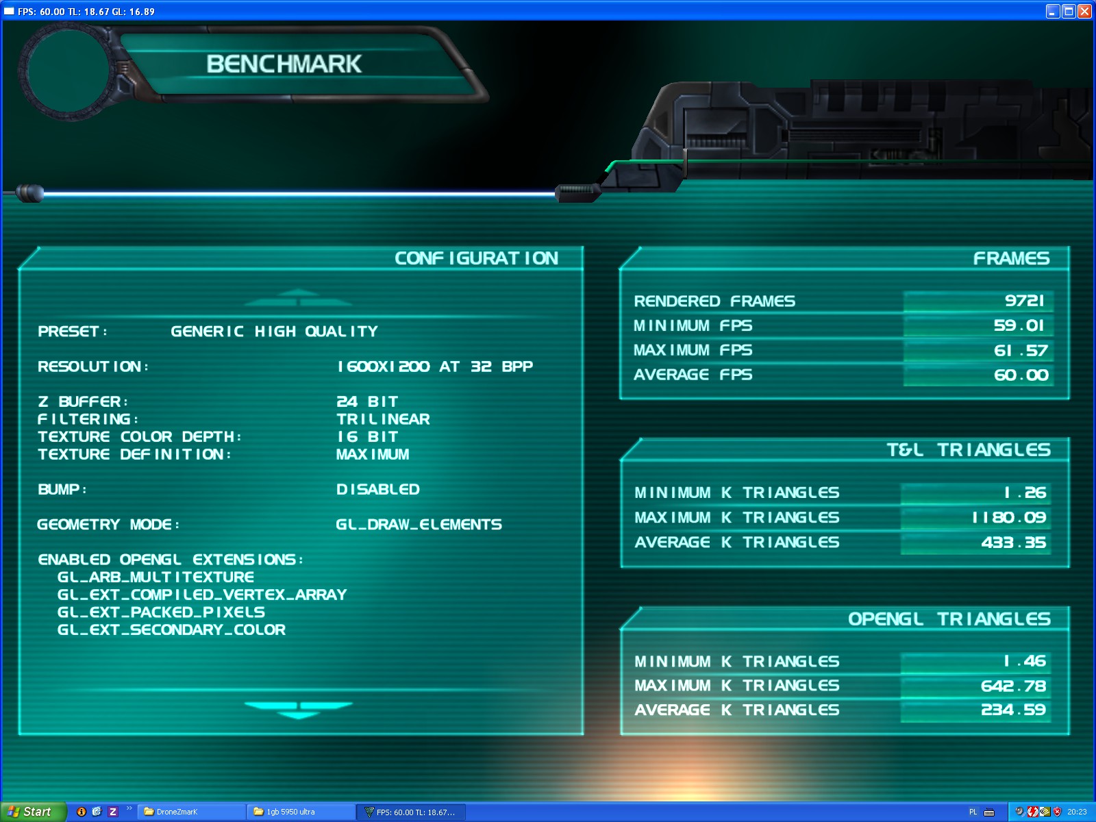

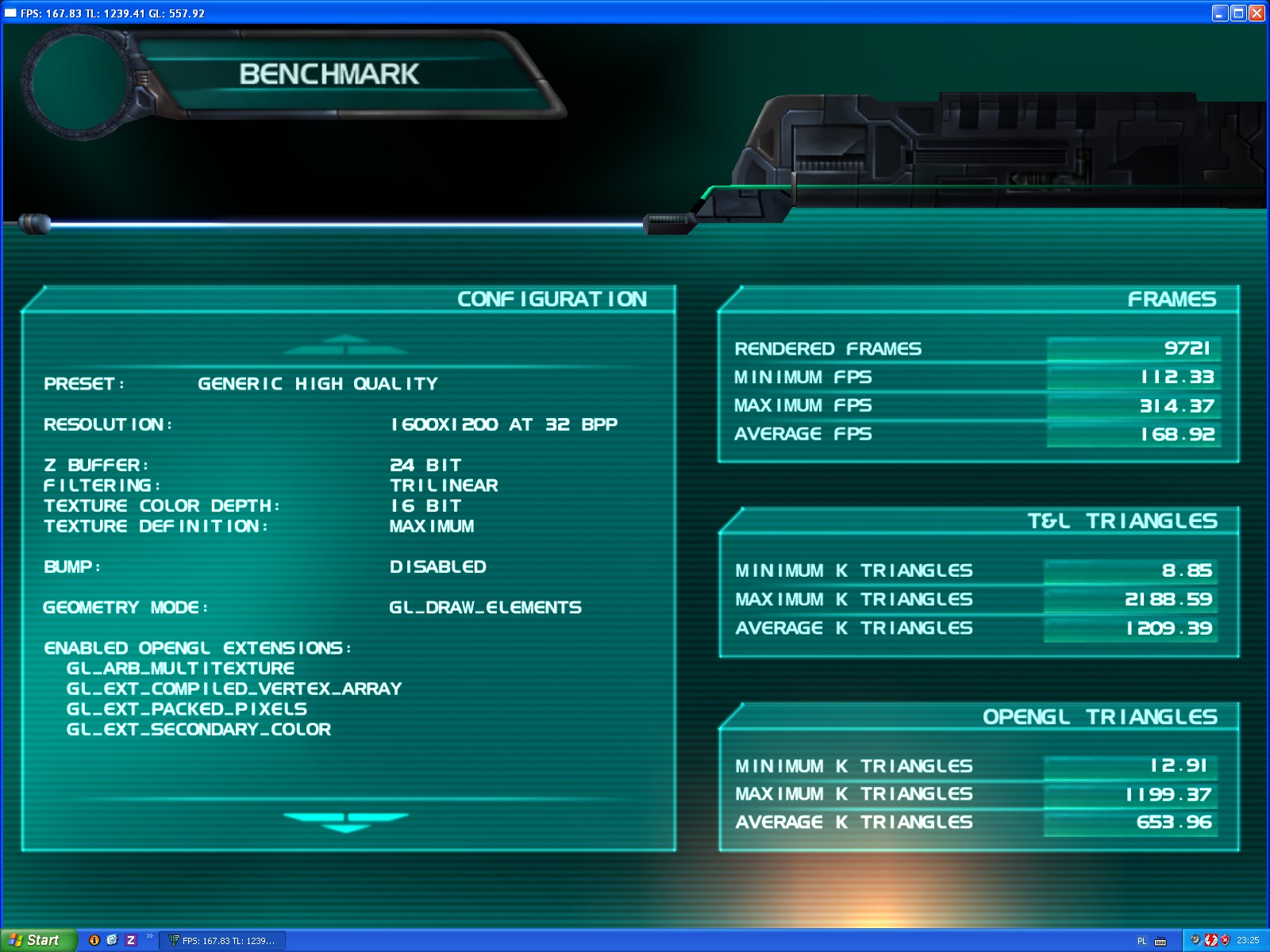

Judging by those test results, one could say that SL6BX at 183 MHz and clocked at 1740 MHz (CL 2.5-2-3-6) is practically as efficient as SL6BY at 166 MHz (CL 2.5-2-2-6) with 1750 MHz CPU clock. I didn't do any more tests on this configuration since it was temporary and not effective.

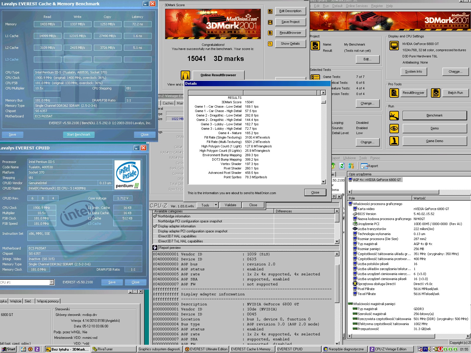

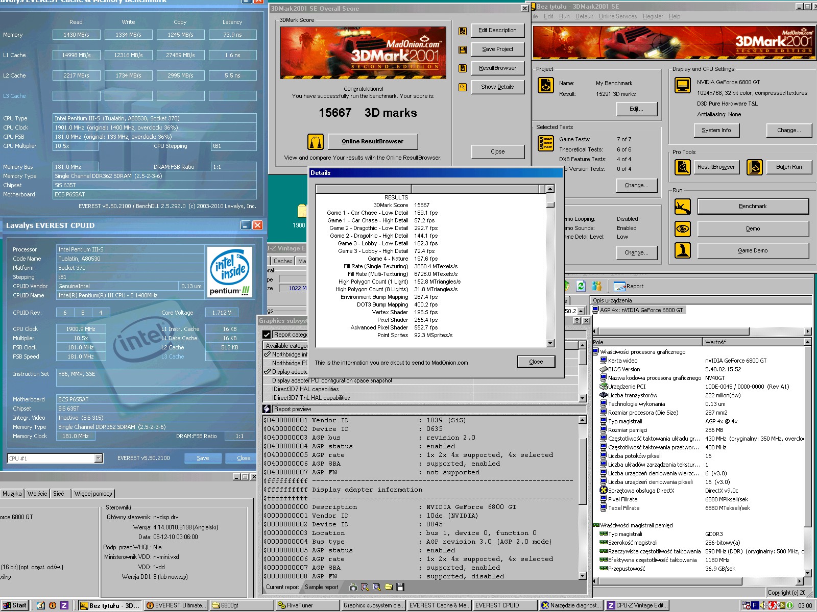

=====================================181 MHZ i 1900 CPU CLOCK=====================================
Ti 4600
WIN98SE!!!! GOODRAM 1 GB NO FW:
cachememRozmiarorygi.jpg 72,2ns latency versus78,3 with 1750 MHz and 166 FSB 😀 Performance gain is 8,5 %
ok2Rozmiaroryginalny.jpg PC MARK 2002 gain from 5492 to 5994 points is a total of 502 points 8,375 % increase.
WIN98SE GOODRAM 512MB with FastWrites:

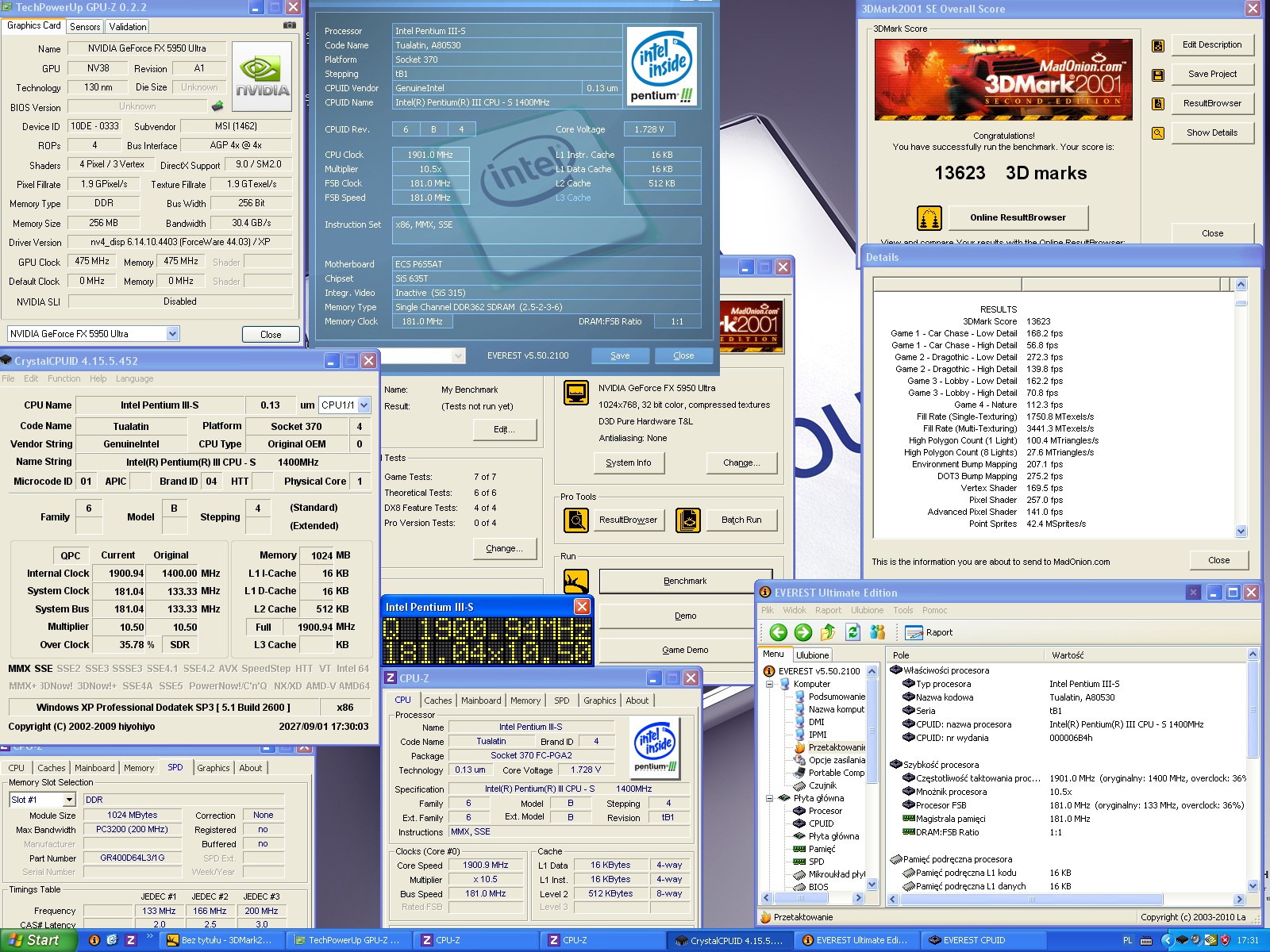

WIN XP: 1 GB GOODRAM NO FW:

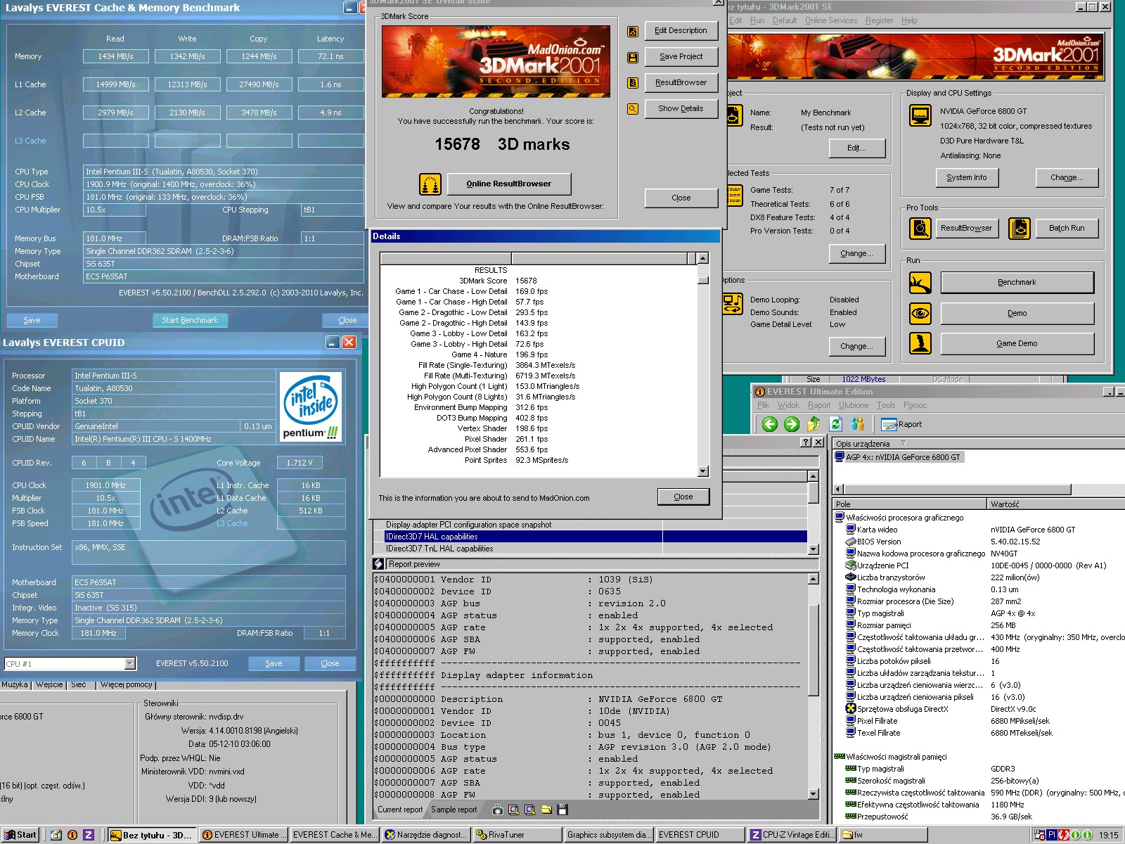

FX 5950 ULTRA
1GB GOODRAM win98:
1 GB GOODRAM WIN XP:
GeForce 6800 GT
WIN 98 & FAST WRITES (1GB GOODRAM)
1defRozmiaroryginaln.jpg - default clocks.
2Rozmiaroryginalny.jpg - light OC
3Rozmiaroryginalny.jpg - max OC - I THINK IT IS THE WORLD RECORD WITH THIS GPU AND A TUALATIN CPU 😀
WIN 98 & FW (512 MB Corsair)
bb03Rozmiaroryginalny.jpg - defualt
WIN98 NO FW (1GB GOODRAM)
2003markRozmiarorygi.jpg - 2003 mark
99provsyncoffrivatun.jpg - 99 mark vsync finally off
defaultnofw1gbgoodra.jpg - DEF 3DMARKS
OC385i540Rozmiaroryg.jpg - OC 3DMARKS
oc430i590Rozmiaroryg.jpg - max OC 3DMARKS
WIN XP 512 MB & FW:
NOW SOMETHING THAT IS NOT POSSIBLE AT ANY OTHER BOARD WITH A TUALATIN CPU AT THOSE SPEEDS!
RADEON 9800PRO
WINXP 512 MB & FW:
WIN 98 512MB and FastWrite:

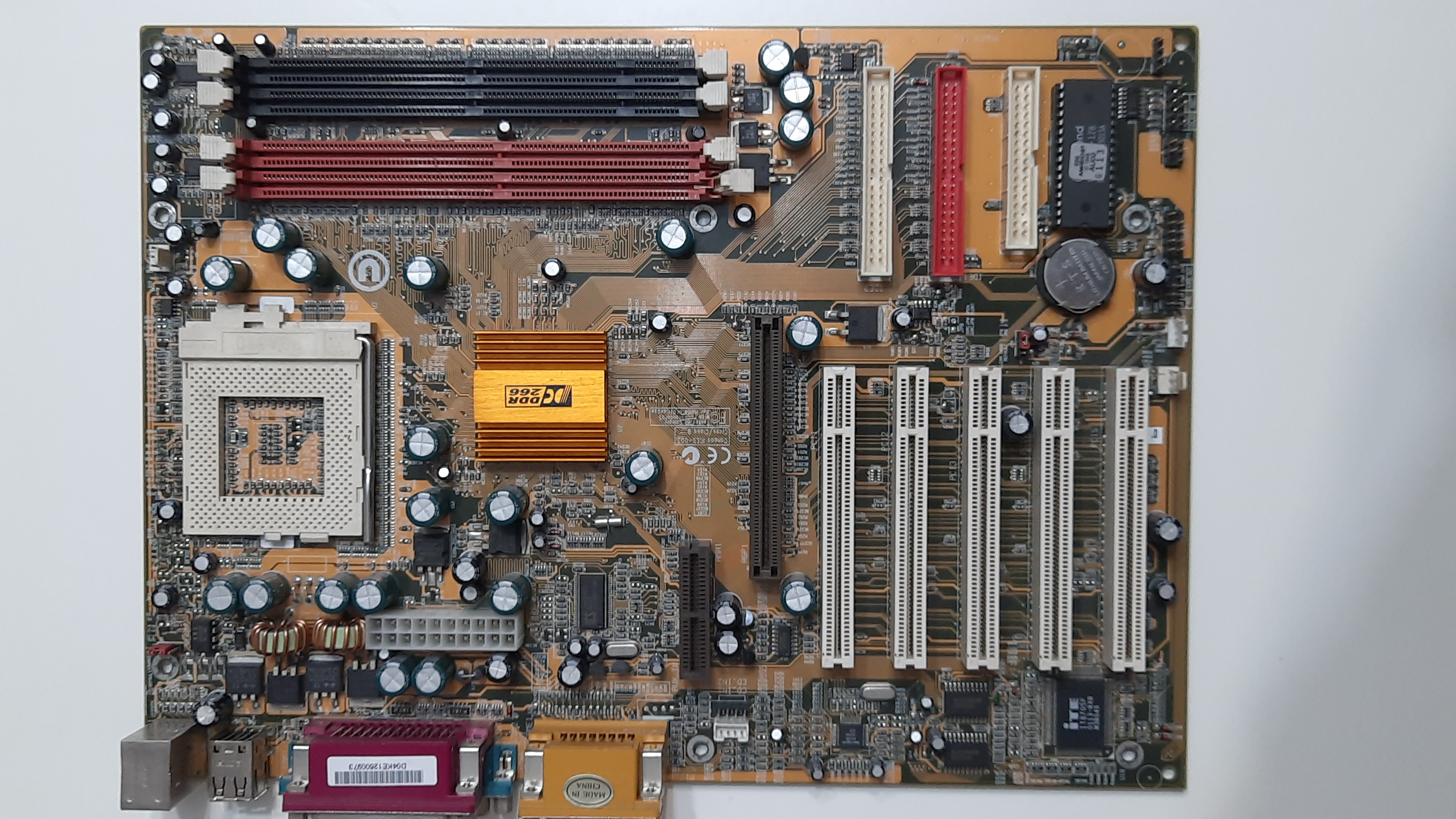

Best Tualatin Motherboard
ECS P6S5AT at 166 MHz
