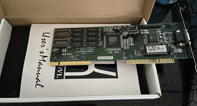

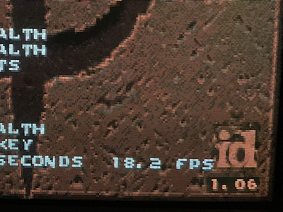

It’s here! Had no idea it was going to include the original box, too bad that’s how they shipped it and slapped a label on it. Although the box mentions 2themax but my bios isn’t marked as such.

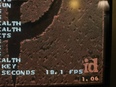

And damn, only getting 18.1 on the ARK, what am I missing? I have jp1 0ws jumper set and JP3 for IRQ9 is also open. This should be fun tracking down!
Can you try whether a 2nd RAM bank makes it faster?
And you should try to open JP1 for 0 waitstates.

Yep sorry I should mentioned this, I’ve added a 2nd ram bank and set the jumper to 0ws for the 18.1 score.
I was thinking to bring it up early but forgot - 2theMax appeared slightly slower than those orange ARK1000VLs.
Can be something simple as a different BIOS version.

Hitting 18.8 in Quake 1.06 dosbench option C on the ARK with VESA Mode 11 320x200 so that’s cool. 0.6fps ahead of the Trio32 in the same mode.
Duke3D scores are so far identical in both 320x200 and 320x400 to the Trio.
But maybe a different BIOS as suggested will push it a tad higher.

Thank you pshipkov but no dice, I was certain this was it, maybe I’ve got a jumper or two different on my motherboard?
Just to be clear, still only hitting 18.1 with pshipkov’s ARK1000 bios, the saga continues!
Pshipkov, curious what speed dram you have on your ARK1000 board? Perhaps they’re faster than the 70ns I have on mine? Maybe that’s the difference?

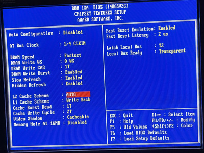

Tried swapping the video card and controller slot positions but no measurable impact. I did discover setting the AT Bus Clock from 7.159MHz to “1/4 CLKIN” or better now gives me a consistent 18.2fps, progress!

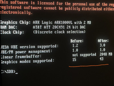

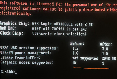

About to chuck the ARK at the wall like a ninja star. I can’t get SDD to give me the same number of modes after swapping the Trio back in and out. Tried deleting the install directory and reinstalling and the last result was 15 modes to 12 🤣. Like WTF. Originally was going from 15 modes up to 43.

That SDD issue - did anything else change between before/after video card swap ?

SDD is just really flaky with this ARK, I re-ran config on it and eventually got back to the 40+ modes. It will configure it different every time.

So what happens if you further tighten the ISA Bus clock ? I think there was 1/2 option. Also, if you set L2 policy to WT instead of AUTO.

No gains if I speed up ISA bus further.
Hrm, the only options for L2 that I have are WB and Auto, do you have a specific WT option? Maybe I’ve got the wrong bios if so.
