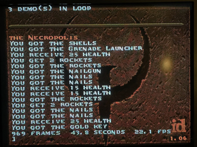

New Score with no peltier. Air cooling only!
AM5x86 200MHz (66x3) @5volt
Lucky Star LSD board w/8ns 256k cache mod
16MB EDO 50ns
312 Fastest, cache and memory timing
1:1/2 FSB:PCI (still some room for improvement!)
Voodoo3 2000
Phils Dosbench Quake Timedemo option C

Is Win95 or WinNT stable?
Reply 604 of 767, by Chadti99
feipoa wrote on 2022-02-10, 02:30:
Testing that now in Windows 98 with Prime95. Was able to run GLQuake for an hour prior. I know pshipkov sent me an image to test with, really need to give that a shot.
But to answer the question, it’s undetermined but looks promising. I’m sure I’ll fire it up tomorrow morning and it won’t be 🤣.

Chadti99, with 3-1-2 and FASTEST at 3x66MHz i see 22.2 fps in Quake1, but system is not fully stable outside the scope of DOS graphics.
That is with both MGA and Voodoo3 2000 or 3000.
I thought I posted about it in the other thread along with the notes about LGS branded memory chips that can do FASTEST, but apparently didn't.
Can double check in one of the next days.
Also, recently you posted such score. Why you are stating new achievement ?
Or did I miss your point. 😀
No I forgot to mention this was a new air cooled score, no peltier.

Chadti99 wrote on 2022-02-10, 12:19:
Wow, so it is @200 MHz air cooled stable?
Have made more detailed post about that motherboard and cache mod?
Reply 616 of 767, by Chadti99
It’s not 100% stable, but it’s close. For my use cases of playing MP3’s and old games I think it’s 99% there at the moment. This is the first AM5x86 I’ve come across that can boot into Windows and run GLQuake for an hour on air cooling @200MHz. Running the heat test on prime95 last night did result in a freeze after about an hour and me trying to launch another app at the same time. I don’t think the motherboard is the deciding factor here but will def try it in more boards in the coming weeks to see. This particular CPU just needs ~5volts to post and run at 200. Which may be a problem for its longevity.

Chadti99 wrote on 2022-02-10, 13:07:
I did not try more than 4V, hmm..
Reply 618 of 767, by feipoa
The Am5x86 at 200 MHz used in the 486 Benchmark Comparison was also run at 5 V and stable w/ air cooling. 4 V didn't cut it.
Reply 619 of 767, by pshipkov
Ok, you really missed the important information 😀
5v to cpu will affect the cpu lifespan.
Live fast, die young.
I didn't explore this area enough, but feel motivated now.
Will give the 3 200mhz capable cpus here a spin on air cooling and see what comes out of it.
But if you slap a low voltage Peltier on that magical cpu that may be enough for complete stability while still avoiding the water condensation.
At minimum you may be able to run 180mhz fully stable on air cooling with 4v or even 3.3v ?
