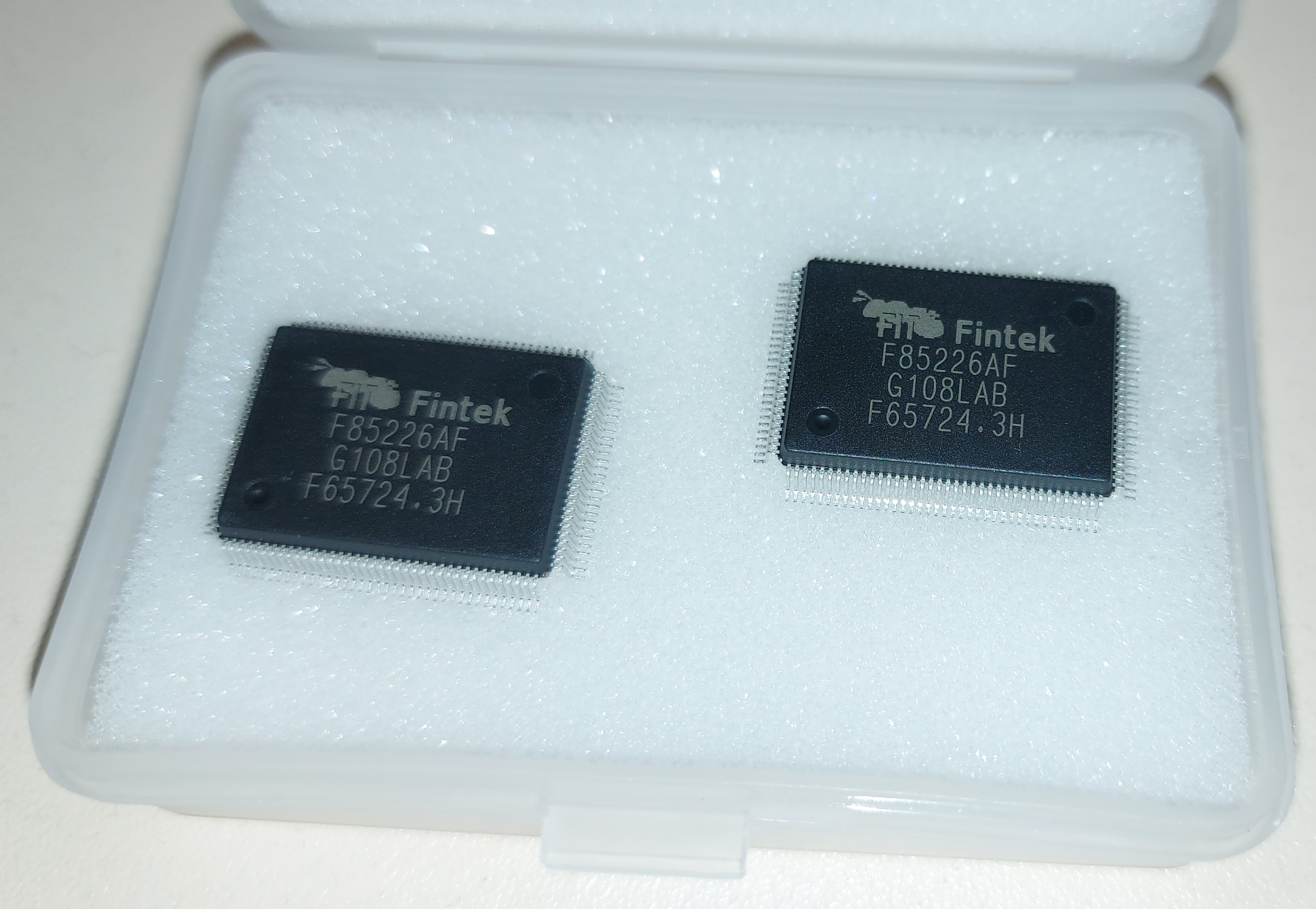

Andrey_Ak wrote on 2025-03-15, 07:37:
I bought 2 pcs. From this seller: https://aliexpress.ru/item/1005006873019772.html I don't know if it's a fake or an original, I […]
I don't know if it's a fake or an original, I haven't soldered the board yet.
Full image:
https://tis.kz/temp/LPC-ISA/20250315_122544.jpg
I believe they are likely genuine. While Chinese manufacturers are skilled at producing counterfeits, this chip simply doesn’t meet the criteria for large-scale fake production.
