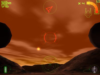

Here's a screenshot without dgVoodoo:
with dgVoodoo:
Wow! Look much better. I may slightly change the colorkeying algorhytm.
On my Nvidia GTX 980 without dgVoodoo, there's transparent parts on the ground/enemy planes and glitchy looking sky.
