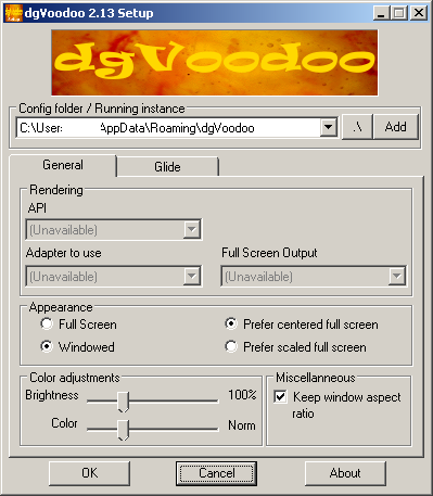

OK, so let's start the discussion.
Does it work for anyone? 😉
the setup doesn't detect anything to choose from for me. I thought it was cause of winxp that doesn't support directx 11, but the same happens in win vista and 7.
    28.64 KiB

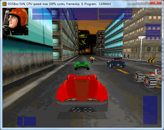

Reply 5 of 3949, by gulikoza
The wrapper runs very fast for me, even on the above Ati card. Perhaps nGlide is a bit faster, but I'd have to benchmark it to make sure. One bug I found is that the HUD elements are not displayed in Carmageddon (works with nGlide, so it's hopefully not something I broke 😜)
    333.77 KiB
    88615 views

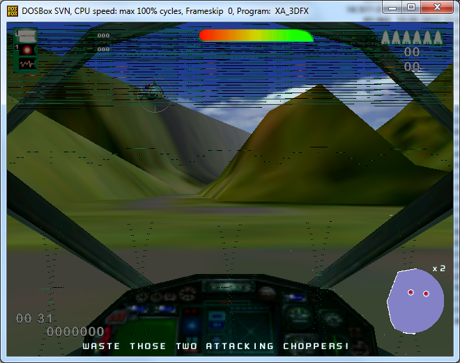

Reply 10 of 3949, by gulikoza
I've fixed Extreme Assault LFB access, but there's still corruption visible (both nGlide and dgVoodoo). These stripes obviously come from LFB writes, if I disable LFB access, they're gone (and so is the HUD). I don't know where the problem is, since any access to the LFB goes directly to the wrapper...
    227.11 KiB
    88495 views
http://www.si-gamer.net/gulikoza

Reply 13 of 3949, by gulikoza
Took a hint from the nGlide compatibility page and updated EA to v 1.23. The corruption is gone, but it's now the same as with the old Glide patch version. Oh well...I thought rewriting the LFB handling would fix v1.01 (and the demo) 😀
(to be clear, I was trying to fix the problems mentioned in "Tips and known issues" from the dgVooodoo2 README 😉 - perhaps the stride limit needs to be removed from dgvoodoo?)
