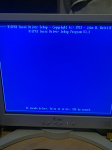

The confusion continues. Jesus... Firstly, am I right in saying that if you edit the autoexec and config files, you should restart the computer? Not necessarily restart to MS-DOS, but just restart the PC and then load into DOS? I've enabled the start/boot menu so I can jump straight in. That's given me a more likely chance of everything loading without errors. Although, if I boot back into Windows, check if the autoexec is still the same, and then restart and load up DOS, it can give me errors about the variables/environment. And the autoexec contents change once back in Windows. I've even set the autoexec to read-only in DOS and it can STILL change the contents. >_> Sometimes it'll load everything up but the audio and I get this message:
Whilst experimenting with it all, and staying within and restarting to DOS, everything in the autoexec has stayed the same. Especially whilst putting it to read-only. No errors. If I get errors, loading everything from SBPCI.BAT loads everything without issue, but I can't get it to load the contents on boot. I put the command in the autoexec for it to load it and it didn't appear to do anything. And on one occasion, it just deleted that command once back in Windows. During all of this, there were occasions where the sound tests worked fine, though rarely. Most of the time it says to press a key to play a sound sample, but does nothing. No keys respond, no sound plays. Likewise, if I install Simon in DOS and get it to detect a Soundblaster, I just get this:
Again, no key presses do anything and there's nothing to select. I have to restart.
Frustrating to say the least.

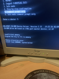

So yay - can’t boot into Windows properly now. 🙁
Even the boot disk hasn’t helped.

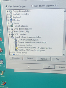

The model of audio hardware I'm trying to use is the onboard sound, which is a Creative Audio ES1373. It has better GM capabilities than my ISA Yamaha, so I'd prefer to use that until I get a wavetable for the card.

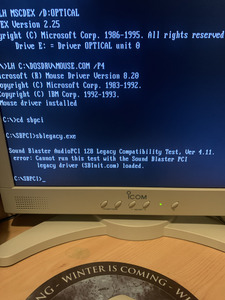

After doing some more experimenting, I was able to get things working correctly just with these commands:
SET BLASTER=A220 I5 D1 H5 P330 T6
SET SBPCI=C:\DOSDRV
C:\DOSDRV\SBINIT.COM
C:\DOSDRV\MT32 /ON
C:\WINDOWS\SMARTDRV.EXE
LH MSCDEX /D:OPTICAL
LH C:\DOSDRV\MOUSE.COM /P4

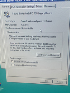

For the first few tests, it was configuring the device without errors. And it allowed me to enable the MT-32 option. The only tool that doesn't seem to work, though it has a couple of times, is the SBTEST. Like I mentioned previously, it asks me to press a key, but no sound plays, and I can't do anything but restart. However, the games I've tested - Simon, Doom, Heretic - were all working.
And then it started again - the same bloody error when rebooting/loading DOS. However, when I looked in the Device Manager, I noticed this, and it isn't the first time I've seen it:
I believe this is why I keep getting that error every time I try to use it in DOS.
