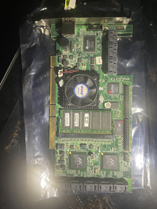

Getcha one of these! :p
Arcea. Uses a intel controller. 16 ports sata 2 300 with ncq.
Doesn’t appear to have 9x support though. 🙁

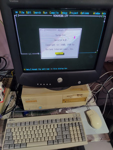

Reply 94 of 156, by Pawlicker
Nice, I got a Pentium Pro again recently (My Vectra VA 's PSU died 🙁 ) but it's something even weirder, a Pentium Pro DOS (not PC) compatible; the NEC PC-9821Ra. It has it's own port of Windows, NT, OS/2 and DOS as well. It has an i440FX chipset and uses EDO Parity SIMMs. It runs games, but not the same kind of games. I need to take PCB photos because the chipset is literally a mix of an i440FX and NEC customs (including a custom video card considered part of the motherboard with the PC-98 video chipset and a Trident VGA chip).
They actually made dual CPU PC-98s with Pentium Pro and II CPUs as well, those are pretty expensive used when they show up. I wanted a regular Socket 8 but this was only $25, and then I bought a Buffalo SXM-F sound card for FM in DOS.
