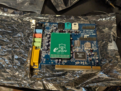

I received a SQ2500 from a friend and I'm not sure what all these headers are for. I attached a wavetable daughterboard as shown but it doesn't seem to be doing much, at least in windows - sound output is silent. Is this right and what do the others do? The manual bizarrely doesn't seem to discuss this at all.
Reply 1 of 26, by SuperDeadite
Most sound cards mute the wavetable header by default. Check your mixer settings.

Reply 2 of 26, by ubertrout
Where are those? I'm trying to use it in Win98 and when I select Aureal mpu as midi device there's just silence. I know there's a dos mixer app.

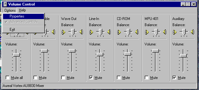

Alright, here are the steps you need to unmute the MPU-401 output on your Vortex 2:
1) Open the volume panel by double-clicking the speaker icon in the system tray.
The attachment 1-volume_icon.png is no longer available
2) From the Volume Control panel, go to Options and choose Properties.

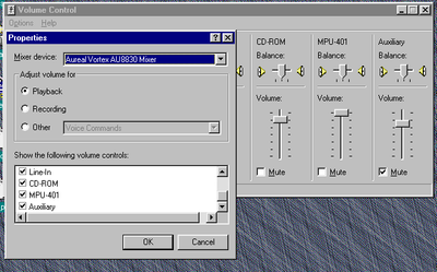

The attachment 2-volume_panel1.png is no longer available
3) Scroll down the list of outputs until you see the option for MPU-401. If it's unchecked, check the box so that it appears in the Volume Control mixer. Then click OK.
The attachment 3-volume_properties.png is no longer available

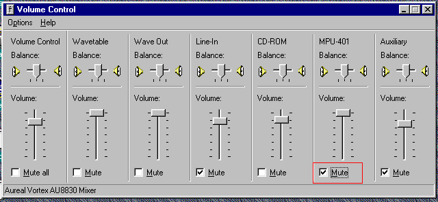

4) Unmute the MPU-401 input. It should be muted by default, at least it was on my Vortex 2 card.
The attachment 4-volume_mute.png is no longer available
5) Select the MPU-401 as the MIDI device in Control Panel -> Multimedia -> MIDI as you did before.
6) To use the MPU-401 in DOS, open the Aureal Control Panel from the Control Panel, go to the MIDI tab, and then change the MIDI device for DOS boxes to "MPU-401" instead of "Aureal Wavetable." (no pic for this one, my kid got up last night as I was taking screenshots)

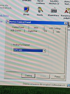

Reply 18 of 26, by Krzysztof Zakrzewski
ubertrout wrote on 2024-05-13, 17:00:
I used a later driver and got the MPU-401 interface to be visible in the mixer. But...still silence when it's selected in Windows after I unmute it. I don't know what's wrong but it's probably something not working on the hardware or something.
I had a similar problem as YOU.
No sound from Wave Header and Windows 98.
Here is the solution that worked for me.
In addition to setting the volume level and turning on the MPU-401 channel as previously suggested, you should also select Analog EQ Channel: MPU-401 in the EQ tab of the card software settings.
Additionally, we have the option of equalizing the sound. Nice!
I hope this helped.
