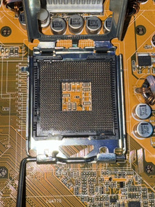

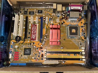

Good day! I recently picked up an ASUS P5NSLI motherboard in unknown condition for free, hoping it would work for my E6700 I had sitting around collecting dust. I got it home, installed the CPU, one stick of DDR2 ram, and a video card and got nothing. It will turn on, the fans spin (the video card fan stays on high), but no post or anything on the screen. I tried without the ram and no beeps. So I uninstalled the video card and the CPU and I could get it to turn on, but still no beep codes.
Looking the board over and nothing looks bad. All the cap's look good, no damage at all. Could the motherboard just be dead or could it be my CPU?
Thanks for the help!

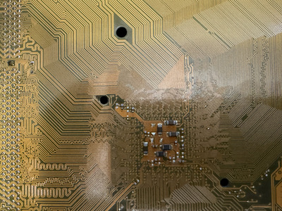

I see discoloration under the north bridge, hopefully solder joints are not cracked under the chip, not a big fan of nForce motherboards with passive cooling.

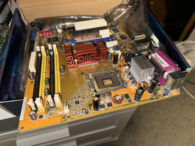

Karbist wrote on 2024-04-23, 18:58:
I removed the chipset heatsink and everything was looking good, no discolouration. It could be the angle of the camera and light....
Reply 11 of 32, by johnvosh
I took and reseated everything, but a fresh battery in. I even took and removed the heatsink from the CPU and had my finger on the power switch of the PSU. The CPU is getting warm, slowly, so I'm guessing that means the CPU is working? I have tried two different video cards and no difference.... Even tried without a video card in and still no beep saying that it has posted or anything.

What´s that black stain supposed to be?
The attachment IMG_0701a.JPG is no longer available

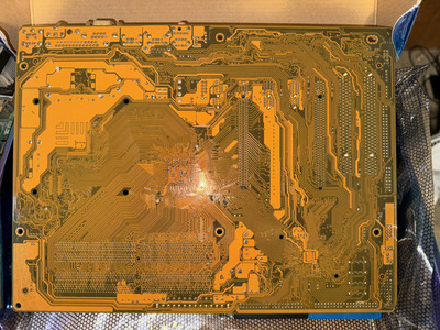

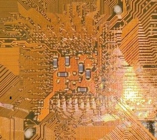

Reply 13 of 32, by Karbist
johnvosh wrote on 2024-04-24, 00:32:
The copper on back of the board beneath the north bridge has darker color in your pic.
The attachment IMG_0702.JPG is no longer available

Reply 19 of 32, by PcBytes
nForce 4 SLi. Forget fixing it, it's bumpgate and nothing will fix it because it's the substrate that has gone bad.
I have had several nForce 4 boards (both AMD and Intel) that have went to the trash for that reason alone - bumpgate riddled chips that did not get a revised version with fixed bumps.
