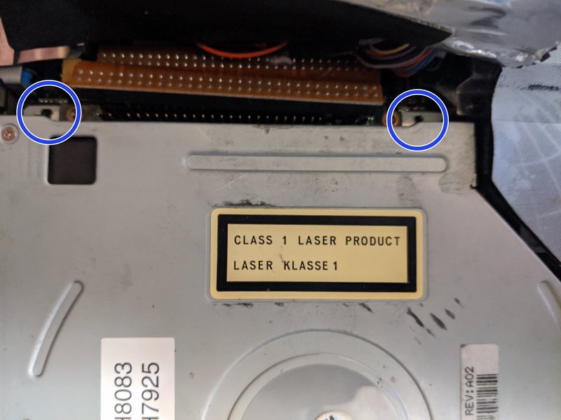

Hi, I have a trouble finding an IDE cable for my Compaq Deskpro EN Small Form Factor. I found similar cables online but not the one I need.
It's simple 50 pins straight pass trough, but it is a slim variant comparing to standard IDE. This is used on CD Drive only. Other cables are standard.

50pin? That sounds like SCSI-2, narrow SCSI 2 IIRC.
The picture ain't the highest res, but counting from a key on a plug to the end there are 13 holes.... If forty, that count would be about 10.
Does the CDROM have a power connector, too? Just wondering if perhaps Companq used IDE, but then a 50 pin cable to carry power, too.
Double check what the CDROM actually is. As a SFF machine, I doubt it has a soundcard with a CDROM controller, then a proprietary interface (the pre-ATAPI/IDE CDROM era). But SCSI in a Compaq SFF? Some workstation, maybe, but an SFF to me says standard Excel/Word machine, not CAD and performance.
The CD Rom gets power and outputs audio trough the same cable. Cable is same on both ends.
Machine is P3 600 MHz, 256 MB RAM, 4 MB GPU. HDD uses standard IDE cable.

Reply 6 of 14, by boby
Ok, I was able to find a cable based on weedeewee advice on aliexpress. Will see if it will fit when it arrives.

I bought 2 cables 50 pins on aliexpress (wrote that on previous post) and they didn't fit, so needed to cut 1 mm of plastic on both side. After I managed to connect it, CD spins in drive but the CD drive and CD are not recognized.
So my purchase isn't good.
What I noticed is that the connector at the end of the cable is twisted for 180 degrees comparing to original cable, so I wonder if I can make somehow this to work? 😒

Ok, so rotating the connector for 180 degrees worked! Cable has this notch, so you can't plug it as you want. Rotating connector allowed this.
P.S. If someone came across same problem, aliexpress cables (from above) worked, but needed modification. At least they were cheep.
