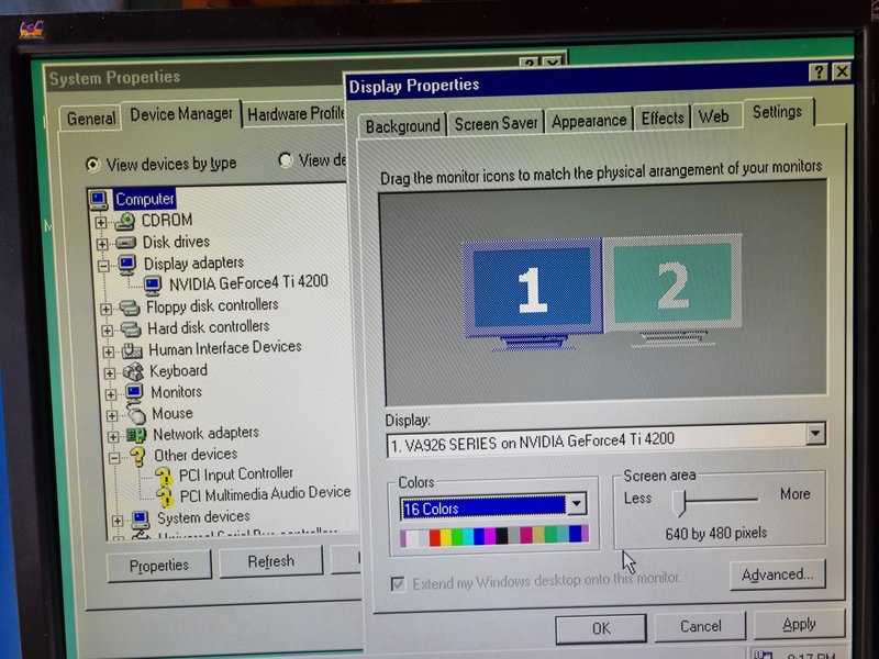

I'm having trouble getting my Ti 4200 graphics card to work in Windows 98
I've tried the 43.45 drivers and the 30.23 drivers but none of them allow me to increase the screen resolution. I also noticed the Nvidia tray icon wasn't present or any additional Nvidia driver options under display settings. The card shows up correctly in device manager.
Spec is in my signiture, its a VIA chipset and the 4 in 1 drivers are installed so im really not sure whats going wrong? Any ideas?

Reply 2 of 18, by swaaye

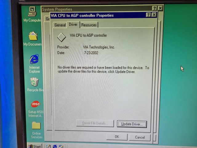

Try switching it to 256 colors or better. Windows will ask to restart. After that it might work properly.
If it still doesn't work, maybe post an image of the VIA CPU to AGP Controller driver version page in device manager.
Which 4-in-1 drivers did you install?
Also, I believe another cause of this issue is an incompatible AGP Graphics Aperture Size in the system BIOS. I would try 256MB.

Reply 4 of 18, by WarhammerDarkOmen
Hi thanks for youre reply
Switching to any res / colour sadly just reboots back to 640x480 16 colours
I'm installing version 4.43

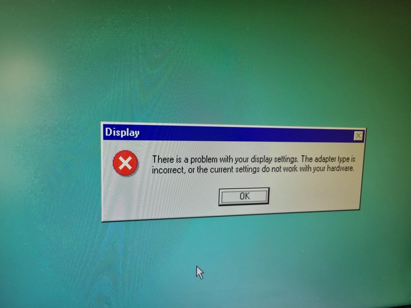

Reply 9 of 18, by WarhammerDarkOmen
I just did a BIOS update on the machine to see if any new options show up, they didnt but nice to have the newest BIOS installed anyway.
I tried a Geforce 4 MX440 in it and it gave a Windows Protection Error prompt at boot, tried the Geforce 4 Ti 4200 and same thing with that now. I can revert back by going into safe mode and uninstalling the nvidia drivers but thats not going to help much.
I have no idea what the problem is.

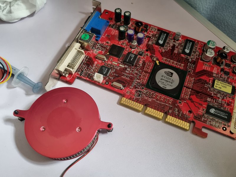

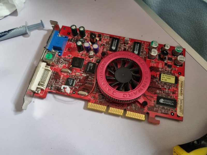

Reply 13 of 18, by WarhammerDarkOmen
Not been doing anything with it as got pretty frustrated. But now I'm going to refurbish all the hardware and hopefully it will fix it.

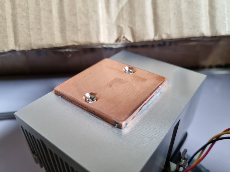

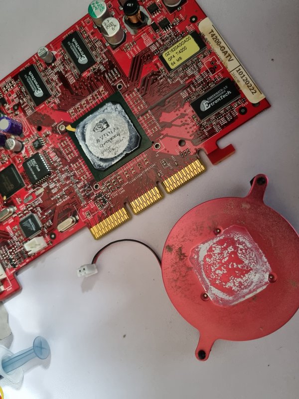

vvbee wrote on 2024-07-17, 17:26:
A small failed capacitor did something similar on my Radeon 9600.
I expect this is the case as the motherboard and GPU have bulged caps.
Cleaned the CPU cooler and new thermal paste applied, CPU also cleaned as someone put half a tube of thermal paste on it for whatever reason.
GPU is waayyyy overdue for new thermal paste.
Waiting on the new caps to come then we shall see if this fixes it.

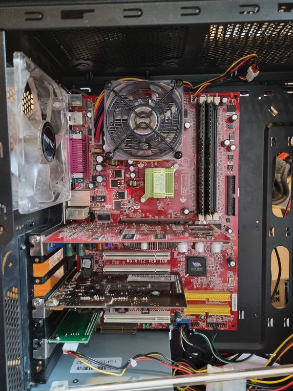

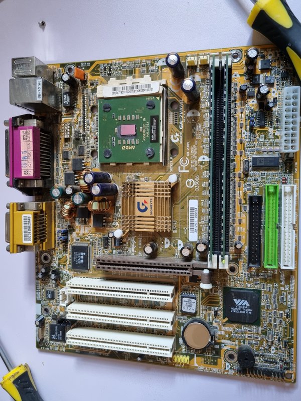

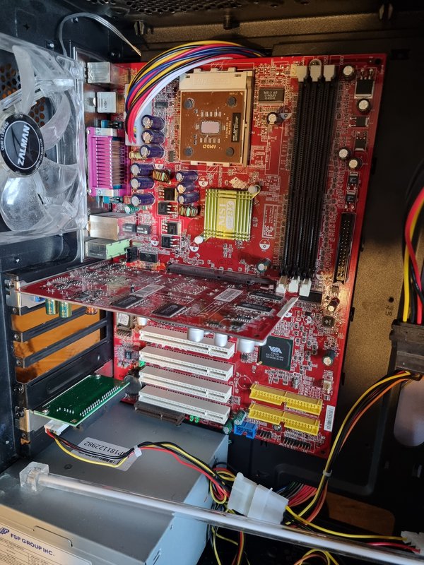

Reply 17 of 18, by WarhammerDarkOmen
This seems to be never ending..
So, I got the caps for the old Gigabyte board but my soldering iron wasn't getting hot enough so I decided at this point i may as well get another board as they are pretty cheap (same price as a new soldering iron)
I got an MSI KT4V MS-6712 motherboard, why? it was cheap and red like my GPU so looks kinda cool.
Arrived today and i assembled it
Tried to start it up and nothing, zero.. dead. Like no life what so ever. I am using an AMD Athlon XP M 2000+ for lower power consumption could this be the issue? As i can't find a CPU list online for this board. Surely it would still power up just not post, no?
I do have a Athlon XP 2400+ still which i will try but at this point I'm close to just giving up. Everything I am trying is just going wrong I've never had this much trouble with building PC's in my life.

Reply 18 of 18, by Repo Man11
The BIOS download page lists the added CPU support with each BIOS - the XP2000 should be supported by even the earliest BIOS but you're good for anything with the last one that even supports Barton cores. https://www.msi.com/Motherboard/KT4V__KT4VL_v1.0/support
