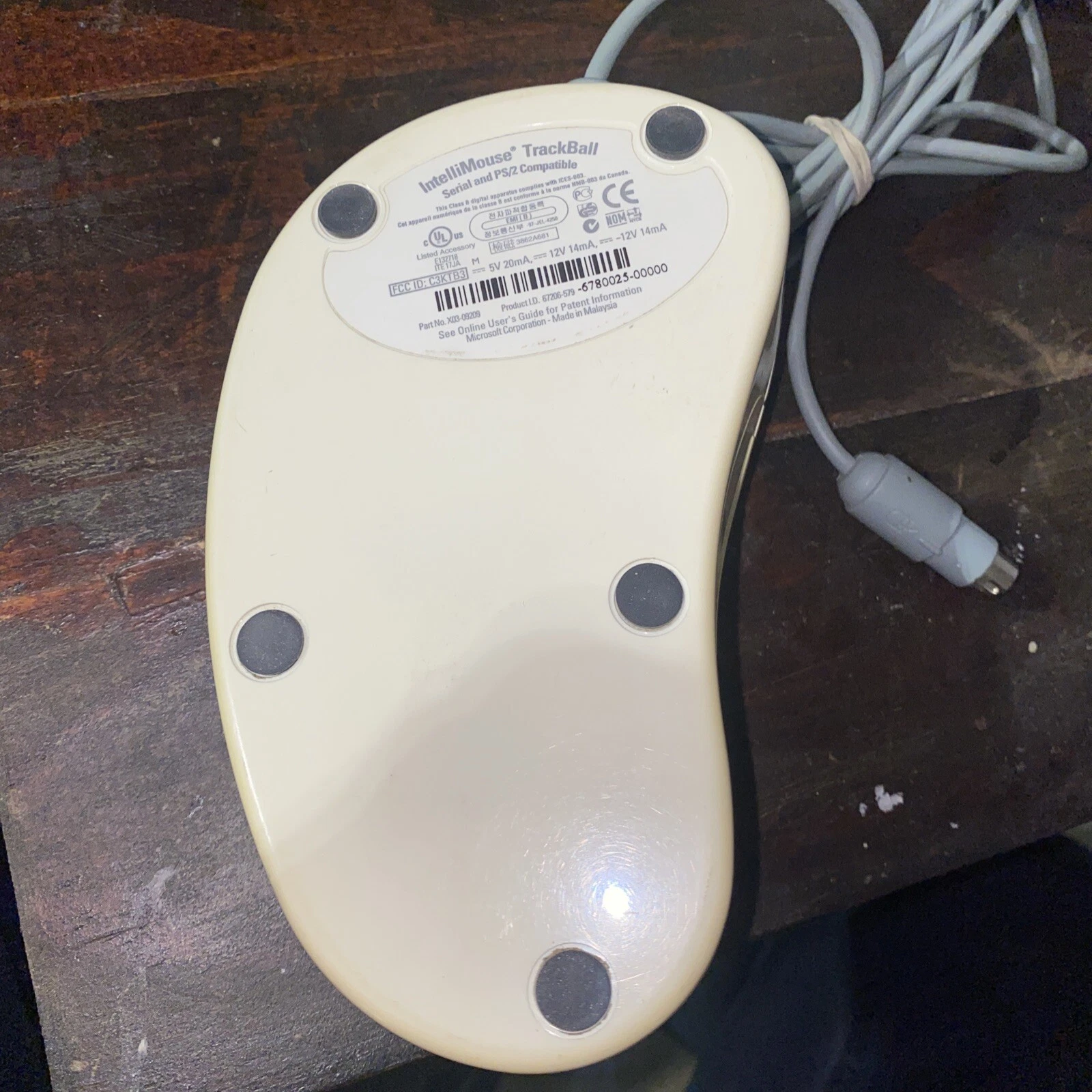

I recently got this Microsoft IntelliMouse Trackball device. I was intrigued by it because it says that it is serial and ps/2 compatible, so I could use it for my systems without ps/2 ports. Does the serial mode require specific drivers? I have not been able to find any, or a user manual that tells you what serial settings to use.
So far with my limited knowledge I have not had success using it as a serial mouse, it does work as a ps/2 mouse in windows 98. I have a DB9 - ps/2 adapter, no idea if it is the right thing for the job.
The system I want to use to test this mouse is a ms-dos 6.0 system with windows 3.1 installed on it. I have another serial mouse that works fine in win 3.1, but it is a horrible optical mouse.
Any help on this subject would be appreciated!

Reply 2 of 11, by dionb
A serial+PS/2 compatible mouse needs a specific PS/2 to serial adapter (it's not a standard, so differing pinouts exist...). Then it has logic to detect which port it's connected to (by voltage level on specific pins) which decides whether it will talk serial (probably MS standard) or PS/2.
So if you have the right adapter, plug it in, run standard serial mouse drivers (mouse.com, but ctmouse should also work) and it should work. If it does work with PS/2 and not with serial, you probably don't have the right adapter.

Post a photo of the backside of the trackbal mouse please.
Something like this https://i.ebayimg.com/images/g/-P4AAOSwydVm7M0r/s-l1600.webp
Which clearly indicates 5v +12v & -12v. Which definitely makes it a ps2 & serial mouse, not USB.
If it is anything like that, odds are good that the adapter you're using to convert the connector to serial is not the right one if not even the standard microsoft mouse drivers can't find it.

Agree ! I have a MS Intellimouse PS2 mouse that says Serial / PS2 compatible and it only works serial with adapter it came with, every generic or Logitech adapter I tried failed.
MS uses some odd pinout different than Logitech or some generics....

Here is the photo, it looks just like the one posted above.
Is it possible that there is a pinout somewhere? I have the skill and equipment to make a cable adapter if the one I have is not right.
Reply 10 of 11, by Alex_03
So it's a few hours later and I have successfully made an adapter. I followed this thread: Microsoft PS/2 to serial pinout?
My mouse was not quite the same, but I reverse-engineered the circuitry and matched it up with the schematic they had. The mouse now works in windows 98 and windows 3.1.
