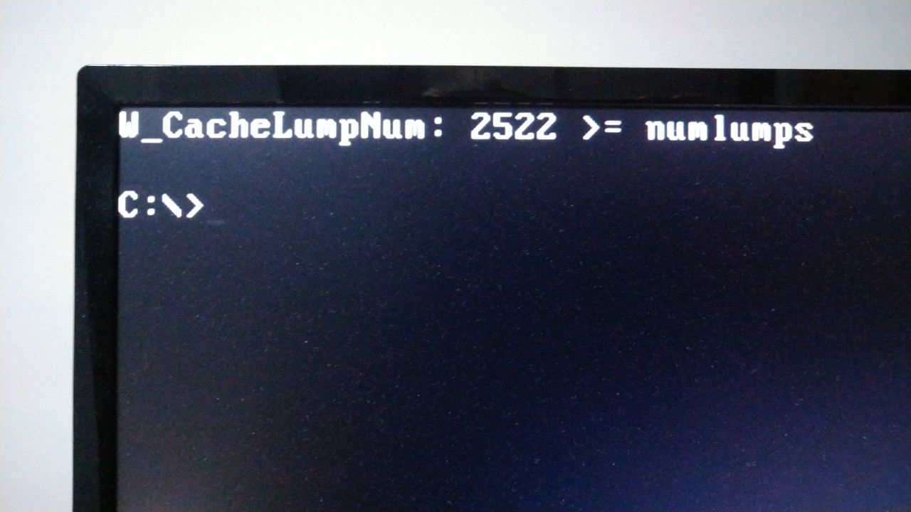

Found this port while looking for a solution to play Sigil and Sigil 2 on DOSBox-X. While running "wcdoom.exe" Sigil runs fine and Sigil 2 starts but then crashes as soon as a game is started with the following error:
Any idea why?

Reply 7 of 8, by Grunt
Avenger wrote on 2026-02-18, 11:39:
Any idea why?
Oh, wow. This bug should have been fixed. It works me in DOSBox-X. Are you sure you've got recent SIGIL2.WAD? You can try to merge both WADs, less lumps to process.

Reply 8 of 8, by Avenger
Grunt wrote on 2026-02-22, 19:38:
Any idea why?
I was initially using the standard MIDI version wad that came as an alternate download when you purchased Sigil 2 with the Thorr soundtrack directly from Romero's website. I also tried with the version uploaded to the id games archive and the modified one you provided attached to this thread with the episode moved to slot 5 and all 3 wads give the same result unfortunately.
