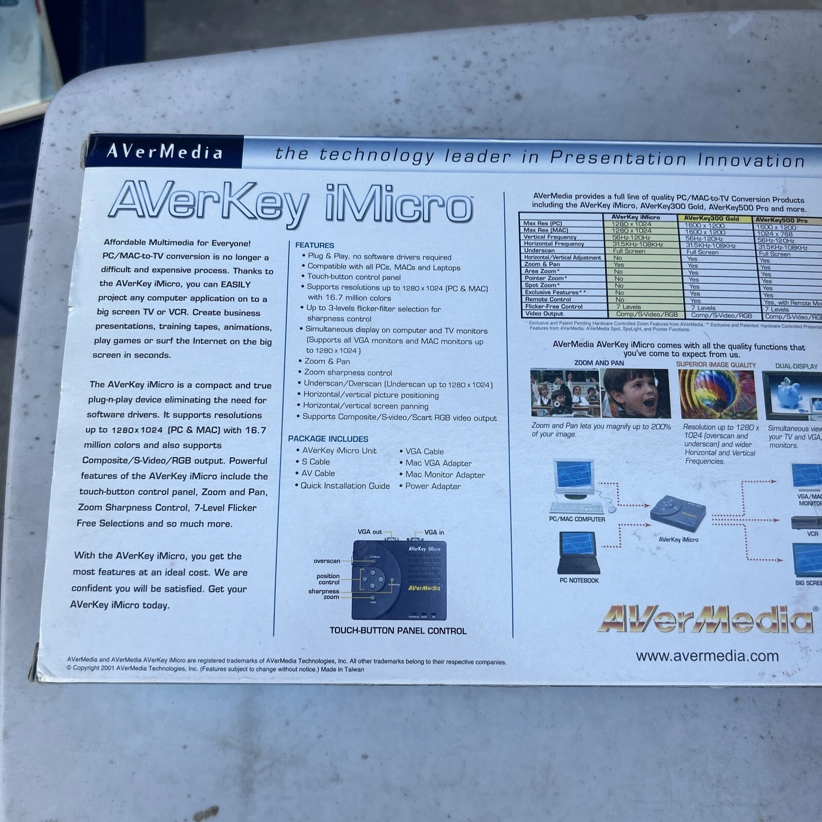

I actually have an AVerMedia AVerTV Box9, but that one only has S-Video etc for input, not for output.
I've looked at AVerKey iMicro and it looks promising, but on the features list, it seems to say that the lowest possible horizontal frequency is 31.5khz, and what I need for 1084S-P2 is around 15khz, no? Am I misunderstanding something?

Reply 11 of 49, by rmay635703
maxtherabbit wrote on 2024-11-26, 13:39:
The 1084 would not be damaged by feeding it 31kHz. It simply wouldn't sync to it
And he is referring to the averkey Imicro input frequency not the fixed 15khz output.
A custom cable is a given but otherwise should be a pretty easy build.
If he wants to send EGA like signals 20-24khz into a 1084 there are better ways.

Yeah, I did some searching and apparently the SCART adapter doesn't come out of the box with the AVerKey iMicro, but is apparently an optional accessory. It is also implied in the manual that there is a separate PAL version of the iMicro, that the cable would come with.
I certainly hope that the NTSC version outputs RGB and can be adapted to SCART as well. The TV that I would want to hook it up to has RGB SCART, but also supports 60Hz NTSC.
By the way, the AVerKey iMicro can indeed be found for cheap on eBay by many a seller, but all of the sellers are in the US, so I'd be paying shipping and taxes that would cost me three times the cost of the device.
It might still be worth getting one, though.
Any idea on how to DIY a SCART adapter cable for the iMicro? The RGB port isn't clearly shown in the manual. Is it just a 15-pin VGA port carrying a 15kHz RGB signal?
