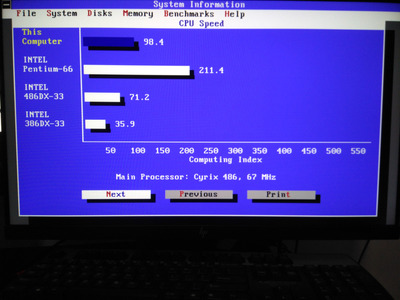

Reply 7 of 43, by MikeSG
You might be right about needing the FLUSH# signal. To boot from floppy I have to disable L1 cache in the BIOS. In normal booting, and after loading "cyrix.exe -f -b- -m", floppies work, but it's probably not writing to memory (loading a program), so I didn't test that properly.
I did get an Acer ALI M1217 board to run 3x faster using the TI486SXL2 at 66mhz. Sis Info runs mostly in the L1 cache though. Which I read is 32-bit not 16-bit.
Compilers will unroll loops if the programmer specifies fast code optimisation. 486s+ want them all the same as any other CPU.
98.4 for the TI486SXLC2 @ 66
35.9 for the standard 386sx
