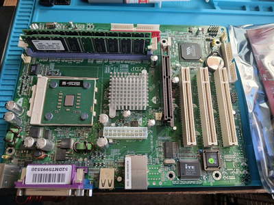

I'm going to hobble together a Windows 98SE build I can use for Win9x gaming. No DOS games on this one. I may "upgrade" it later, but with the parts I currently have on hand, this is what I'm thinking.
Sempron 2500+ (May get 3000+ later on, still reasonably priced.)
512MB DDR 3200
Radeon 9250 128MB DDR (AGP)
Sound Blaster Audigy EAX Advanced HD – SB1394 / SB0090
However, limited other options are available.
GeForce 6600 GT 128MB (AGP)
GeForce 6200 256MB (AGP)
Sound Blaster Audigy EAX Advanced HD – SB0160 (Nearly identical to SB0090? Lacks gameport.)
Sound Blaster Live – CT4870
All I'm looking for is 60'ish stable FPS on most 3D Win9x games at 800x600 or 1024x768.
Seem reasonable? Or do you suggest a switch?

Reply 1 of 58, by User5518
The Sempron is a budget-oriented CPU. If you have the chance to upgrade to an Athlon, I would highly recommend it.
The Radeon 9250 is decent but not particularly powerful. A Radeon 9600 Pro, 9700 (Pro), or 9800 (Pro) would offer significantly better performance.
As for Nvidia's 6000-series cards, their driver support for Windows 98 is subpar—at least in my experience—so I wouldn’t recommend them for Win98 gaming.
Regarding the sound card, the SB0090 Audigy is a solid choice and should provide excellent sound quality.

Reply 4 of 58, by StriderTR
Thanks for the feedback. 😀
I know there are better options out there, these are just the parts I have on hand and what the build will start with.
I'm just curious how they would perform in a Windows 98 SE based system at those resolutions.
I may get a better CPU and GPU down the road, but for now I'm just going to use what I have.
The Sempron 2500+ is Thoroughbred and only has 256K L2, that's the primary reason I was thinking I may pick up an Athlon 3000+, for the 512K L2. Everything is going to depend on how these starting parts perform.
I failed to mention in the original post that I also have a board with an Athlon 64 3200+ I was going to use for this, but the fact it uses PCIe turned me off using it for Windows 98.

Reply 8 of 58, by momaka
Looks like a nice build forming up so far, but... oh boy, those silver Sacon/Evercon electrolytic caps absolutely need to be changed - every single one of them. I can see most are bulging already. Do it before something gets damaged.
As for the video cards... you might actually get decent enough performance with the Radeon 9250 if you don't mind 800x600 resolution. One advantage of the 9250 over the newer cards is that it still has proper support for 16-bit modes, so might offer better game compatibility. With R300 -based cards, I remember reading here that this got removed or is not as good.
Also, another plus for the Radeon 9250 is that you can easily keep it cool by having an 80/90/120 mm fan blow air at low speed (read:quiet) on its passive heatsink from far away. You can essentially pound the crap out of it with gaming, and yet never have to worry that it will break / go bad on you. Plus, it's a low power card, so will be easy on the PSU requirements (probably only going to need about 3-ish Amps on the 3.3V rail.) With that Sempron 2500+, you could probably easily run that rig on a 150 Watt PSU, provided it can source around 15 Amps on the 5V rail.

EDIT: Only ones I found were direct from MSI, and the farthest they go back is XP 32bit for the chipset drivers:
https://www.msi.com/Motherboard/RX480M2/support#driver
Reply 17 of 58, by StriderTR
Ozzuneoj wrote on 2025-02-07, 01:57:
That should definitely be interesting with an ATi chipset. Those are quite uncommon. […]
... I honestly couldn't find any chipset drivers for it online in 3-4 minutes of searching just now... like... any at all, let alone for Windows 9x. So yeah. Hopefully you can locate some. 😮
candle_86 wrote on 2025-02-07, 01:45:
id avoid ATI for windows 9x
After a LOT of searching, I found squat.
So, looks like a Win98SE build is on hold. I don't seem to have any good hardware lying around that will do what I want.
Could use this for an XP build, but not sure how good it would perform.
Retro Blog & Builds: https://theclassicgeek.blogspot.com/
3D Things: https://www.thingiverse.com/classicgeek/collections
Wallpapers & Art: https://www.deviantart.com/theclassicgeek
Reply 18 of 58, by waterbeesje
This would be a decent XP machine. The sempron was a budget cpu but not a bad performer. The 9250 wil stand its own of you dont require max settings. The 6600 would outperform it. Of you can find a faster card like the 9800 or x700 that would help ofc, depending on availability and if the price would be right for you, you may consider them.
You may up the ram to 1GB or maybe some more, as it relaxes the use of the swap file.
For audio, Audigy is great! Just yet then and see which one is the best version for you.

Reply 19 of 58, by Ydee
StriderTR wrote on 2025-02-07, 04:03:
After a LOT of searching, I found squat. […]
Hm, what is problem? Do you really need ATI chipset drivers for W98? I have working build with W98 on little more recent AMD 760/710 chipset without chipset drivers, with X700 and GF7600 (but you can use even GF 6xxx with official W98 driver, GF7xxx has only modded unofficial) - it is not most appropriate build for W98, but I don't see any more serious problems.
