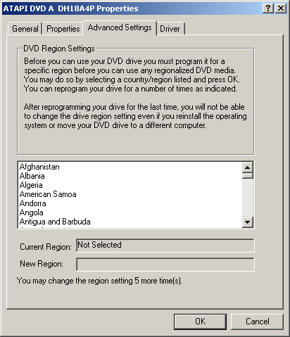

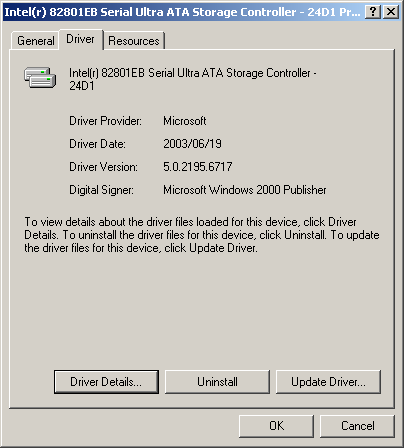

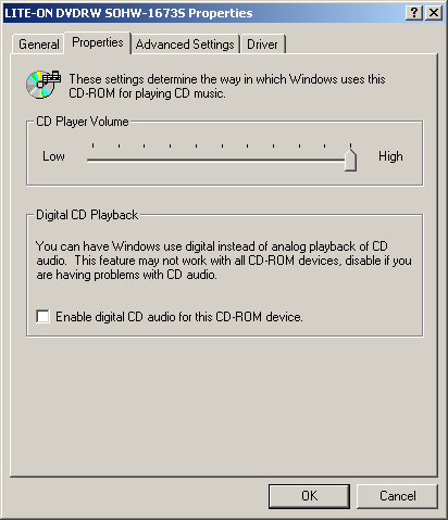

(DVD Writers In My Computer Windows 2000)
(My Device Manager List In Windows 2000)
CTRLRP01.png CTRLRP02.png CTRLRP03.png CTRLRPDD.png Primery04.png Secoundery04.png LTDVD01.png LTDVD02.png LTDVD03.png LTDVD04.png LTDVDDD.png ATDVD01.png ATDVD02.png ATDVD03.png ATDVD04.png ATDVDDD.png
(Dual IDE/SATA Controller and Primary and Secondary IDE Controller and DVD WR Driver Properties in Windows 2000)
