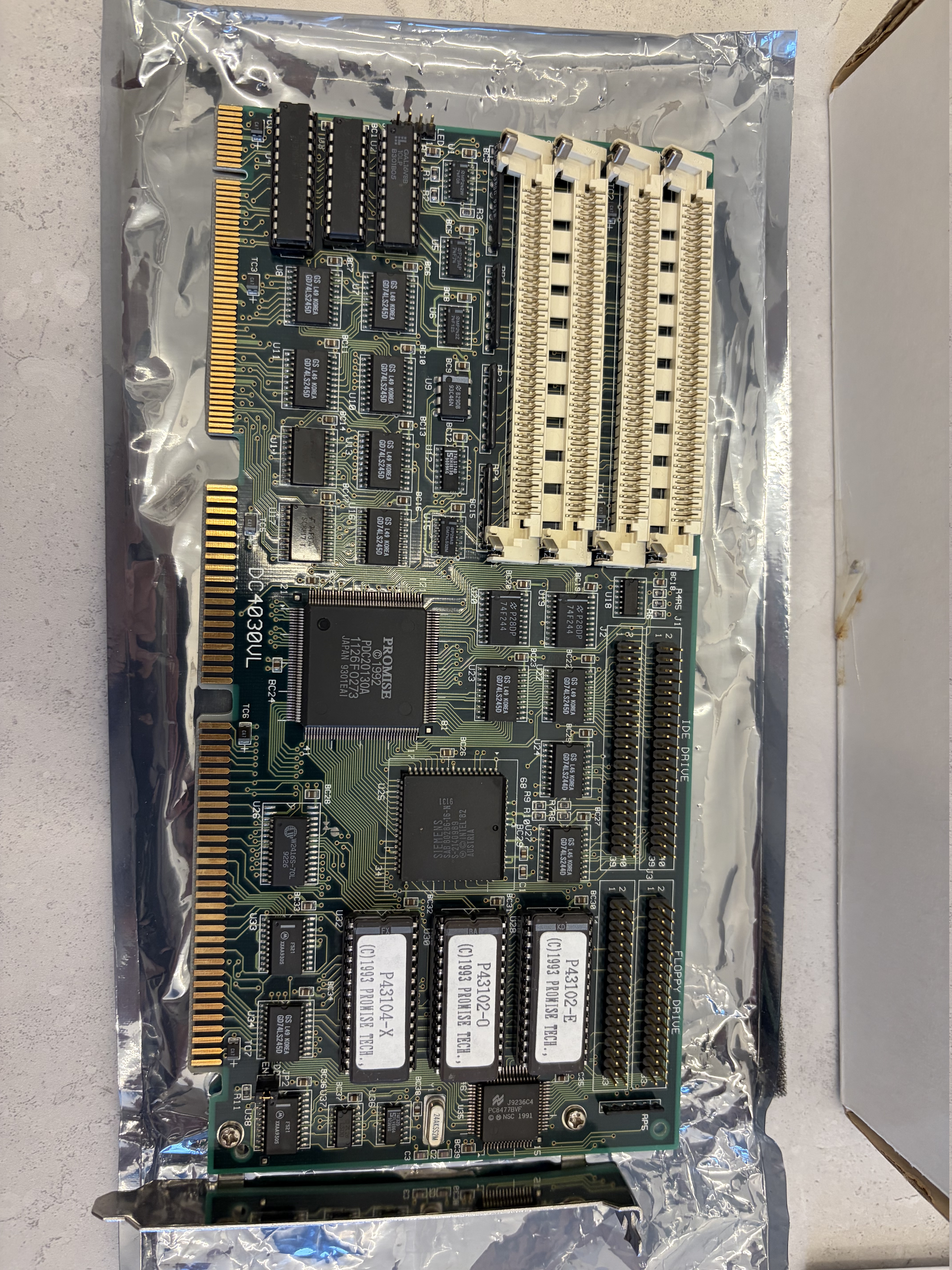

Reply 5 of 8, by Omarkoman
I got this card, here is a pic:
https://i.postimg.cc/JmTwwjm5/IMG-1581.jpg
Can I load up the above firmware to get lba support? Is it only up to 8gb?
Reply 6 of 8, by douglar
There were 4 cards. here are the newest bios that I found
DC4030VL -> your card, descrete ide logic. 1.2 bios is limited to 8.4 gb
DC4030VL-1 ->pdc20230c controller, 2.2 firmware/ 2.3 bios, limited to 8.4 gb
DC4030VL-2 ->pdc20230c controller faster cpu, 4.6 bios supports lba up to 30gb at least.
EIDE4030Plus ->pdc20230c controller, shares bios and firmware with the vl-2
You could always try the lba bios on your card. just dont lose the old roms.
Reply 7 of 8, by Omarkoman
Thanks, so where do i get 1.2 bios for my card to get 8.4gb ?
