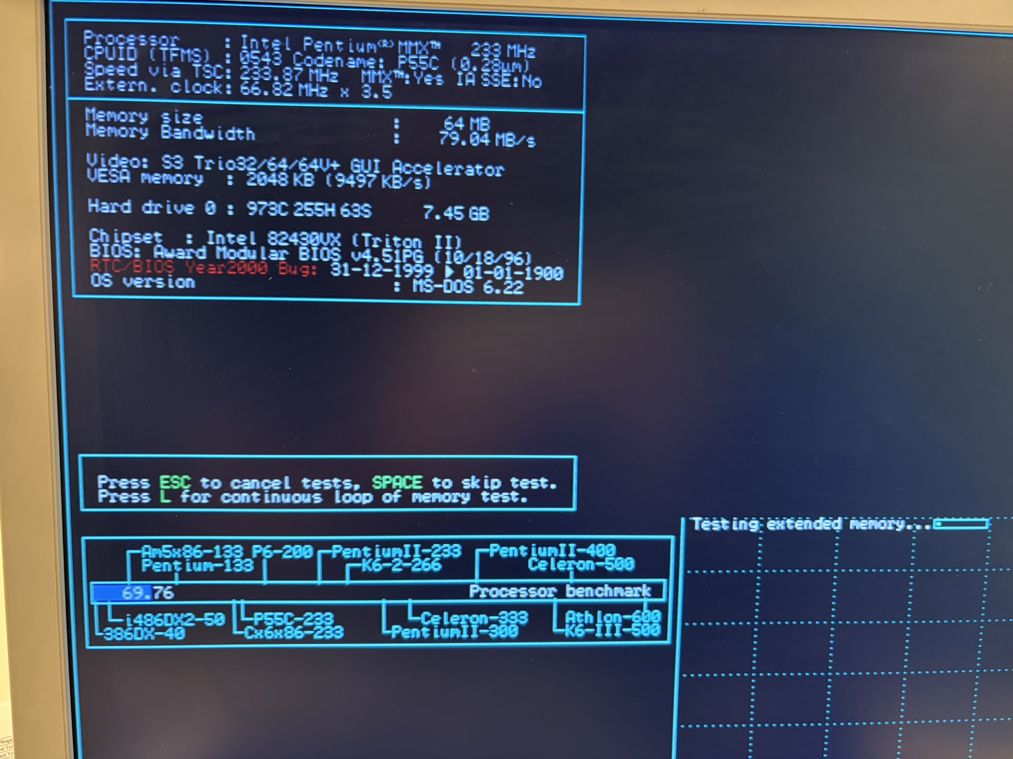

thanks for these, I figured leaving the multiplier at1.5x makes the 233MMX run at correct speed.
the issue is now, why does adding an ISA sound card slow down the system so much ?
see screenshots:
Reply 7 of 16, by Matth79
Ensure that JP2 is set 1-2 and BIOS has ISA = PCICLK/4 and Peer concurrency is enabled, might be worth going to a later BIOS
Reply 8 of 16, by Repo Man11
You can save the Speedtest results, then convert them to a .jpg which makes it easy to post. I have a very similar PCChips M520 and it had no L2 cache, though it does have a cache slot. With any other manufacturer I would assume that the board has L2 cache since it has no slot to add any, but this is PCChips - is your image cut off?

Reply 9 of 16, by Omarkoman
Matth79 wrote on 2025-10-21, 22:23:
I will check the JP2 but the PCICLK/4 is set and peer concurency is enabled.
It definitely has cache and after trying few other ISA sound cards it appears specific sound card related - opti930 chip, a real shame as its a fantastic sound card. Might need to do more research on this.

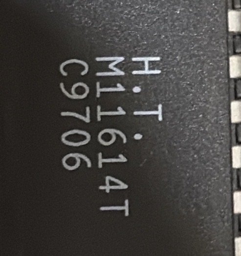

Per PCChips you can use the same BIOS for the M520 → 538. I'm using Jan Steunebrink's patched BIOS with my M520.
http://www.steunebrink.info/k6plus.htm

Reply 14 of 16, by Omarkoman
Ok thanks, will give it a try.
Reply 15 of 16, by Repo Man11
There can be an issue with the BIOS size since PCChips used whatever was handy (lowest cost) so they used different size EEPROMS and had different BIOS.
A lot of times when you first start out on a project you think, This is never going to be finished. But then it is, and you think, Wow, it wasn't even worth it. - Jack Handey
Reply 16 of 16, by Omarkoman
Hm, i used the large version as the chip indicates thats what it is.
Photo of bios chip on the board:
https://i.postimg.cc/GbVcNbyj/IMG-0379.jpg
Admitably, when flashing, awdflash did warn there is some mismatch but I flashed it anyways thinking surely I got the right file (and knowing i can reflash later if it doesnt work).
