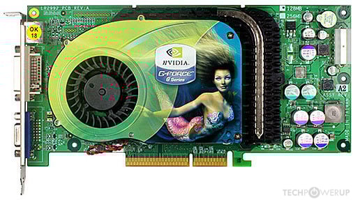

WcDuck wrote on 2025-12-29, 18:52:
Any suggestion?
https://tehsiggi.github.io/agp-power-monitor/
Maybe the graphics card is just overheating?
The 9700/9800 has very poor cooling, and the thermal grease may have dried out.
But you'll never know, because normal temperature monitoring was only introduced starting with the 9800XT.
For the GF6800, with comparable age and power consumption, cooling looks like this.
https://tpucdn.com/gpu-specs/images-new/c/177 … front-large.jpg
