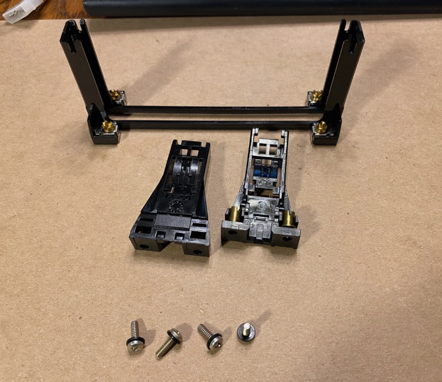

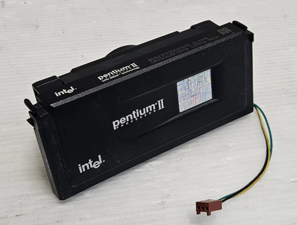

Reply 3 of 6, by Omarkoman
Another question I have is around slot 1 retention clips / brackets.
I dont have much experience with Slot 1 from the 90s as all machines I was using back then had standard socketed cpus.
I noticed that the current Celeron has a cooler / heatsink on it that "clips" into the two retention brackets on the sides.
This means that cpus like this one:
https://i.postimg.cc/4GDMF8HD/p2-300.png
can not ne inserted without removing the side retentio clips.
How can such CPU be installed in board like this one? would I need to get a bracket / retention clips like this ?
https://i.postimg.cc/vGxfjvnY/bracket.png
Reply 4 of 6, by Disruptor
I would give a Slot 1 Mendocino Celeron 433 a try - if you can get it easy.
Your Deschutes Pentium II probably won't start or run stable in your motherboard. It is likely your BIOS won't have the microcode updates for that Deschutes Pentium II.
Basically the CPU may also fit without retention clips.
Does your board have a retention set installed?
Reply 5 of 6, by Omarkoman
Yes the board has a retention set but its different to the one I pictured above and the existing celeron 333 has a heatsink with notches on each side where the retention clips "clip on" when pushed into the socket./
