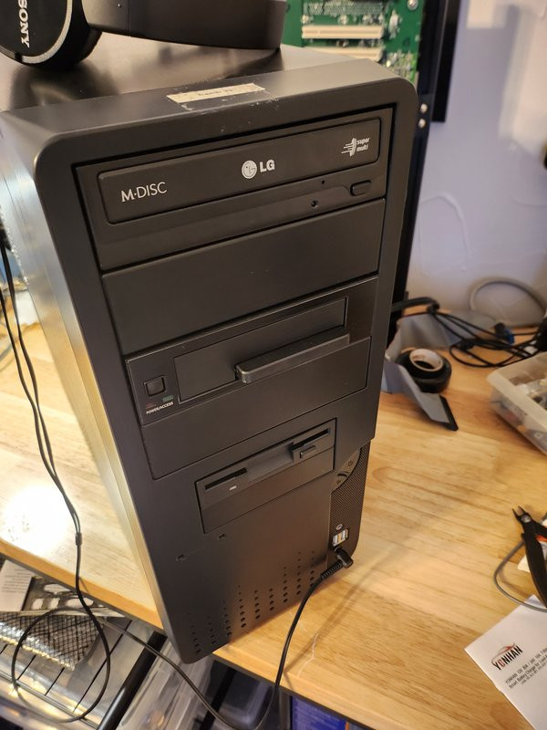

I'm probably going to make my own breakout cable using an old/cheap headset cable and some pins/header that will plug straight into the ac97 connector. It has a nice 90 degree jack that will look pretty clean on the back once done. This also resolves the "jack sense" option as well.

Mission accomplished!
The breakout cable is complete and works just fine.
I think the biggest change I would make if I do this again is spring for an audio cable with a 90 degree jack for a cleaner look, but other than that it is ready to go.

Here are the final pics:
(Orange is the AC97 connector, Blue is the three pin connector with the exposed ground wire safely surrounded with electrical tape.)
In the future I will use the "Correct" 2x5 pin housing for a professional\clean connection and an extension cable with a 90 degree jack, but for now it is working...
Let me know if anyone has any questions\comments...
