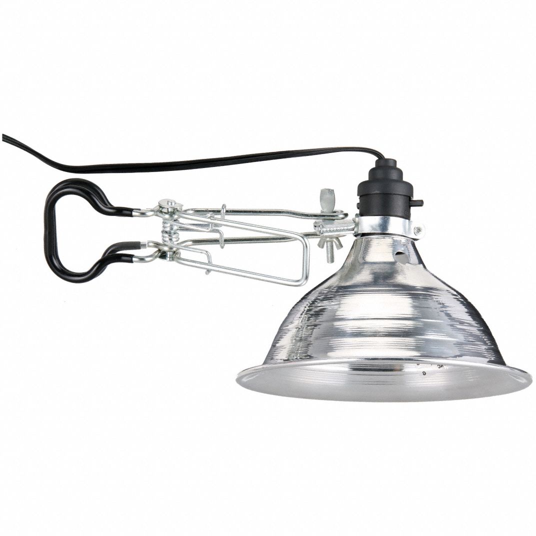

Reply 14 of 28, by wierd_w
bakemono wrote on 2026-02-25, 15:06:
I tried the 'hacks'; they all took way too much time. I tried two purpose-built erasers; they both broke for no apparent reason. Finally, I bought a germicidal UV-C bulb that goes in a standard bulb socket, for like $15, and erasing EPROMs is a nonissue. I switch it on for 5 minutes down in the basement, so I don't have to smell the ozone, with a cardboard box covering it to prevent eye exposure.
If it can go in a standard edison socket, then why not use a metal parabolic, face-down on a table?
2V647-A0020-1_v1?$adapimg$&hei=1072&wid=1072

Reply 16 of 28, by bakemono
wierd_w wrote on 2026-02-25, 15:21:
The bulb I have is about 7 inches long, so using a horizontal orientation allows lining up a whole row of chips underneath. Mounting the bulb in a hood to prevent incidental exposure is possible but would require a relatively large/deep hood.

Reply 17 of 28, by wierd_w
They DO exist..
66394037.jpeg?size=xl
