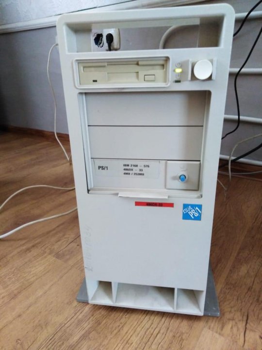

Back in 1993, IBM released the PS/1 2168
One of the last IBM PS/1 machines, was equipped with 486DX or DX2
Model 2168 was a tower. It had more 3.5" and 5.25" bays as well as ISA expansion slots present on a special daughterboard. In front, a sliding cover is a characterisitcal part of this machine
There was a variety of 2168 submodels, so in some units the volume trimmer in front controlled the volume of MWave sound chip, while in older units it controls PC Speaker.

the motherboard i have only has 1 ide connector for floppy drive, and 1 ide connector for the hard drive.
So i am wondering how did they connect a CD-ROM drive to the base models?
Was the CD-ROM drive connected directly to an IBM soundcard using an ide cable?
Was the CD-ROM drive connected with the same IDE cable as slave that is connected to the Hard drive?
was the CD-ROM drive connected to a special ISA card (that the base model did not have) to make it work?
i am trying to understand how to upgrade it with a cd-rom drive, what are the possibilities that can work, in order to install a cd-rom drive into the most base model that did not game with a soundcard nor with a cd-rom drive.

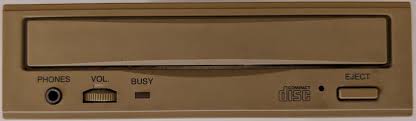

About CDROM, if you look at pictures, is a Matsushita that can use MKE-Panasonic CD-ROM interface or IDE
images?q=tbn:ANd9GcQ7uPeM4GNdaAsGFHzBAghZNnO-hB2dhR_dUw&s
In theretroweb i can see still MKE interface units was made in 94,
https://theretroweb.com/cddrives/433
I dont really think any IBM came with CDROM in IDE interface. But i dont know exactly what sound card they use, in mine came a MWAVE, that dont have any cdrom connector

I have this IBM with a IDE 128GB HDD in master, in slave a panasonic 12x CD like picture, and a AWE64 with IDE and i attach a ZIP 100 pata
You can connect the cdrom to internal ide or sound card is same
