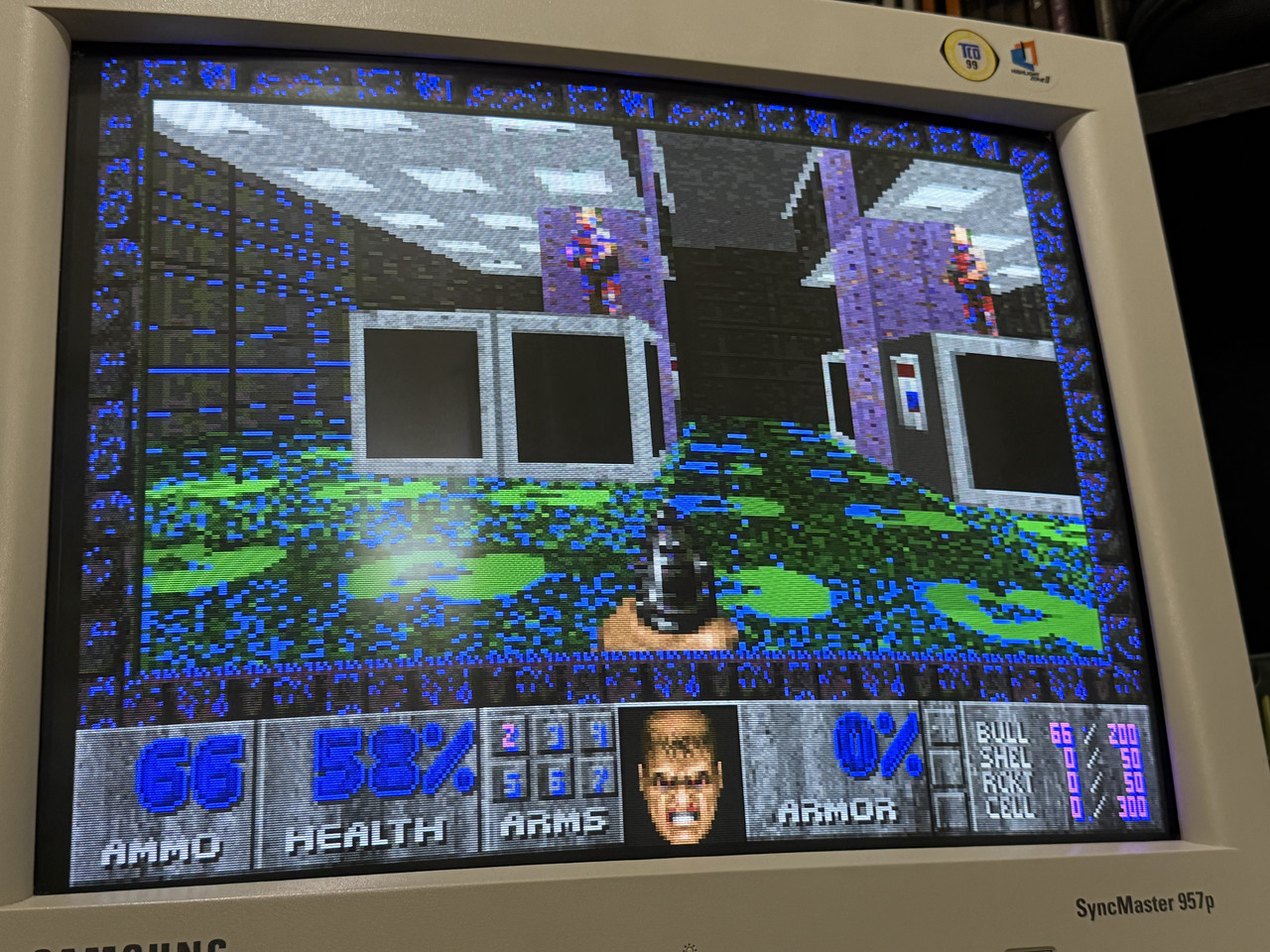

I’ve just been trying out a 486 system with a Cyrus Logic GD5428 VLB display adapter and have had some issues with weird colours. A few examples -
Doom 2 seems the worst, it sometimes flashes to completely incorrect colours. Reliably this happens when the screen flashes on taking damage and it goes very blue for a while before snapping back to normal. Sometimes does it on the main menu too.
Day of the Tentacle - The colours go wrong on the Lucasarts screen, the blue swirl turns green and the logo takes on a pinkish hue. Otherwise seems ok in-game.
Beneath a Steel Sky - On the Revolution splash screen, the brightest part of the background is purple or blue.
I have installed the utility software but it doesn’t seem to matter what I set it to. I have a more modern Samsung CRT.
I have switched to a Trident TVGA9000C 16 Bit ISA 512KB VGA Video Graphics Card and all the above issues go away.
What could be the problem with the Cirrus card? Is there something I can change or is it likely faulty?
