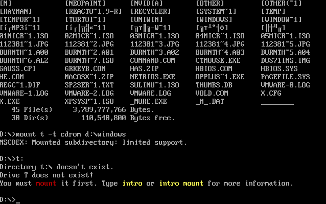

Reply 4 of 9, by ykhwong
I cannot mount cd-rom drive with limited support.
    18.69 KiB
    888 views

Reply 5 of 9, by Dominus
Rank DOSBox Moderator
DOSBox Moderator
does that make sense to mount a directory with -ioctl?

Reply 8 of 9, by Kronuz
I now know where the problem is... I suppose it's a small design fault in MSCDEX_AddDrive() it returns an errorcode, the errorcode it's 0 if no error was found, and another number if something went wrong... or does it? well, almost.
0 = MSCDEX_SUCCESS
1 = MSCDEX_ERROR_MULTIPLE_CDROMS
2 = MSCDEX_ERROR_NOT_SUPPORTED
3 = MSCDEX_ERROR_PATH
4 = MSCDEX_TOO_MANY_DRIVES
5 = MSCDEX_LIMITED_SUPPORT
6 = MSCDEX_UNKNOWN_ERROR
Every single one of those non-zero codes is a "fatal error" making the mount to fail (and every one of them should destroy the half-created cdrom object) however, MSCDEX_LIMITED_SUPPORT isn't a fatal error, actually it's a success code (even when the "cdrom" has limited access, it succeeded to mount it.) This breaks the "0 means succeded" supposition I had. I think those error codes need to have a close look and better more consistent values; perhaps fatal errors could be negative integers, while success errors could be positive numbers and the 0... perhaps implementing a global common errorcode scheme with macros as SUCCEEDED() and FAILED() would be a good thing.
* Okay, I decided to post a temporary patch, this would make it easier for you 😀
