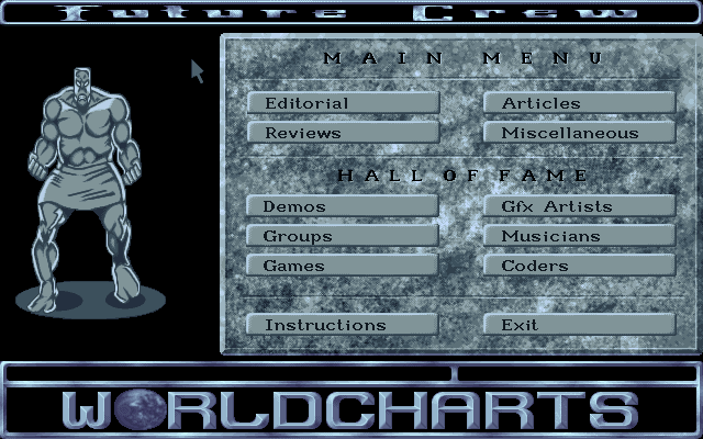

    The wcharts "diskmag" uses multiple palettes

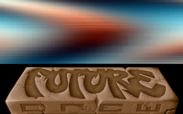

    The panic demo makes the video display jump to different memory locations for each scanline

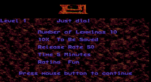

    Lemmings uses two palettes for this screen

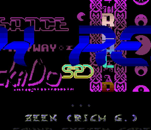

    The dowhackado demo uses different palettes and suffers from a timer bug

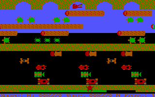

Very nice. Might be useful with CGA too (background colour, in particular). That would help tremendously with Frogger (which changes background colour to blue for the water part at the top of the screen).

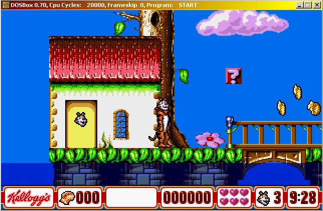

Kellogs comes to my mind, uses pel mask changing to draw some part

Yeah, I see. In previous versions of DOSBox, the sky always was dark blue. Now, in 0.70, ithe sky flickers between dark blue and blue.
    15.31 KiB
    1941 views
    Kellogg
> of the screen blue (water level).
That's why I brought it up recently 😉 can't get it to run.
Runtime error 002 at 0004:2C46.
