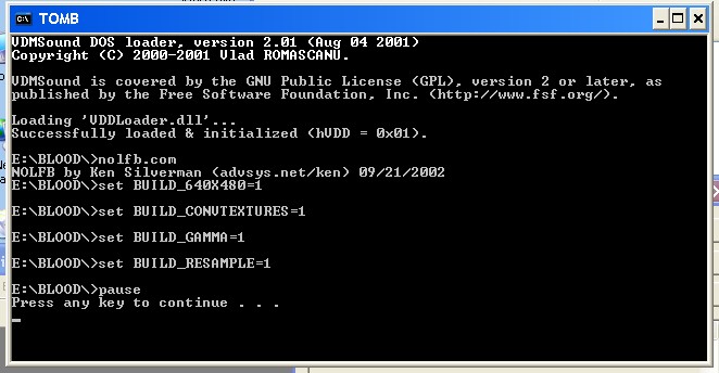

I am having no luck getting the retail version of Blood to work. By launching it through Glidos, I get to the Blood menu screen (new game, options etc.), at which point the game seems frozen (can't scroll through menu etc.). In fact, my PC is almost dead at this point - for a short time I can access the windows toolbar or CTRL-ALT-DEL to task manager, but I cannot kill glidos or recover, and end up having to reboot.
Any help would be much appreciated! Detailed info below
Otipher
After installing Blood, I followed the instructions for patching Blood first to version 1.1 (r0011.exe), and then the 3dfx patch (r1120.exe).
I have launched Blood setup and tried various sound configurations, including "no sound fx, no music" and exit with save, but it doesn't change the behavior described above.
I have a registered copy of Glidos installed (v1.22) and it works fine with Tomb Raider. I have VDM installed with the second set of updates and shell update. I've attached the VDMS log file resulting from running Blood through Glidos below.

Reply 1 of 31, by Duffman
if you want glidos to work on xp with blood you need a VESA high resolution patch called nolfb. go here:
http://www.advsys.net/ken/build.htm
download nolfb.zip, extract and run in a .bat file along with 3dfx.exe
example
nolfb.com
3dfx.exe
note: you should check if this works with regular non-3dfx blood first
you also need to modify your glidos.ini file to have the .bat file in place of 3dfx.exe
example
Executable: E:\Blood\(name of file).bat
ControlJudderFix: 100 <--(also try changing this value see if that helps)
Resolution: 3
FullScreen: Yes
ForcedTextureSmoothing: Yes (turn this off it shoulnt make any difference)
BloodFix: Yes

Reply 2 of 31, by otipher
I did have nolfb.com already in the folder (forgot to mention).
However, I made the changes to glidos.ini you suggested, and separately tried changing ControlJudderFix to 1
Same symptoms (frozen menu screen)
Another few noteworthy items
- while at the first prompt for "Press any key to continue . . ." the PC is running slugishly, as though the DOS app is consuming a lot of CPU cycles
- while at the second prompt for "Press any key to continue..." (the one on the page with the 3dfx alpha message) the system is almost non-responsive outside of the DOS box, by which I mean clicking on windows apps or menu buttons take - literally - minutes to respond. However, selecting the DOS app, and pressing the space bar, blood boots instantly
- while at the Blood menu screen, same behavior as above - windows not responsive - except that Blood itself is also non-responsive
Any ideas?
I'm not clear on whether setting up VDM shortcuts and properties for 3dfx.exe will change the emulation environment of Blood when launched through Glidos or not? If the answer is that it does, are there any experiments to try there?
What about the warnings in the VDMS log about DMA requests? Is that a possible source of problems?
I have posted my blood.cfg file also (VESA mode, no sound fx or music).
thanks for help received so far!
Otipher

I attach a screenshot of something you may already know about, or maybe not - don't know if its relevant. It shows that when Glidos creates a DOS box to launch Blood, the title bar of the DOS box is "TOMB". Does this indicate Glidos is getting confused, or is this just a cosmetic anomaly? I see this artefact on both my PCs.
Something I've been attempting as a diagnostic step, is to supply 3dfx.exe with command line arguments -quick -nocd -nodemo. These are described in bloodhlp.txt. This may eliminate some problem areas. However, I cannot get Glidos to pass these through to 3dfx.exe - I tried both the below:
1. changing glidos.ini to invoke e:\blood\3dfx.exe -quick -nocd -nodemo. Glidos complains that it cannot find the game to launch (it seems to think the options are part of the file path it has to launch?)
2. creating a blood.bat specified to glidos.ini that invokes nolfb.com, 3dfx.exe -quick -nocd -nodemo. when glidos does its stuff, I never see these arguments echoed (always just 3dfx.exe is the command).
I'm also surprised to see that a file glidos.bat seems to get created regularly in the e:\blood directory. Is this file sometimes being called by Glidos to launch blood instead of the one I specify? The content are similar so its not so easy to tell.
Otipher

Reply 16 of 31, by otipher
hmm, interesting.
showthread.php?s=&threadid=31
According to the thread above I don't need it for XP, but the mention of Blood 3D and freezing at startup caught my eye...
Q. When do I need to run CLI2NOP?
A. When most compatibility lists suggest that you do so. Generally speaking, it is a problem that largely affects BUILD engine based games (Duke Nukem 3D, Blood 3D) and other popular games which use the same engine that DOOM, DOOM2, and Hexen use. That is, any game which is a protected-mode application and requires DPMI emulation to be enabled when you attempt to run the game, say, enabled with a utility such as VDMSound Launchpad. So the two factors to pay attention to are:
if it requires DPMI
it freezes / locks up sometimes at "start-up."
Reply 17 of 31, by Glidos
When you try VESA modes without Glidos, you still need to use NOLFB.
One thing not to forget is that when you try with Glidos, you get the first frame, and that means a lot of things are working up to that point. That means your OpenGL is probably okay.
Sorry, not much else that might be useful I can think to say.

Reply 19 of 31, by Glidos
I'm pretty sure I didn't use CLI2NOP on Blood.
One thing I have remembered: VDMSound comes in two parts. There's an installer, and an archive of files that form an upgrade. I use only the former. The one time I tried the upgrade under XP, I got lock ups.
Glidos creates glidos.bat in the target game folder on every invocation. If you specify a .bat file in glidos.ini, then glidos.bat will call your .bat file.
