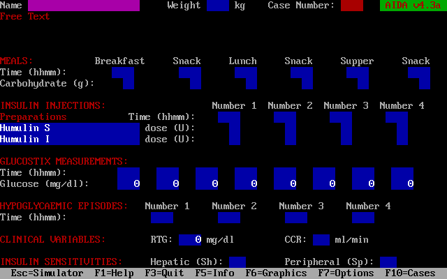

The program works using the default information entered when starting for the first time.
But I made it crash doing these things :

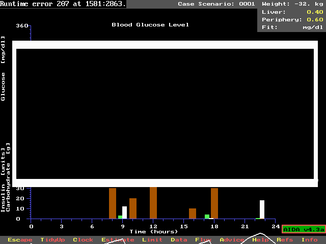

Enter 99 for the weight and enter the simulator (weight jumps to -32) -> Runtime error see screenie.

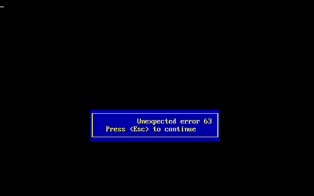

Start the program, using the default info on screen, Esc to the simulator and then Esc back to the default screen. Doing this three times the third time switching back to the default screen the program crashes. See screenie.

    Runtime error after setting weight to 99.

    Unexpected error after 'Escaping' a lot.
    6.62 KiB
    759 views
    After having the unexpected error continuing to 'escape' the program warns you it lost data and enters the screen with no data entered.
