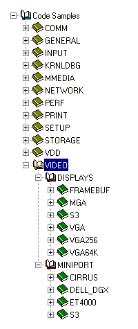

Reply 10 of 41, by vladr
I don't remember where I stuck my copy of the NT4 DDK, but according to the NT4 DDK docs (which I still have handy), the stuff below (waaaaay below, i.e. see attached .gif) is included as sample code. I don't think VGA.SYS is in there (though tons of miniport drivers are).
Also, in Win2k at least there is a VGA.SYS as well as a FSVGA.SYS (full-screen VGA.SYS??) Does anyone know squat about that?
Also, here's some old news from the DDK (for the record).
VGA-Compatible Miniport's SvgaHwIoPortXxx VGA-compatible miniport drivers in x86-based machines replace the system-supplied VGA […]
VGA-compatible miniport drivers in x86-based machines replace the system-supplied VGA miniport driver. Therefore, VGA-compatible miniports must have a set of SvgaHwIoPortXxx functions to support full-screen MS-DOS applications as the system-supplied VGA miniport driver does.
The designer of a new VGA-compatible SVGA miniport driver should adapt one of the system-supplied SVGA miniport's SvgaHwIoPortXxx functions to the adapter's features. As already mentioned in VGA-compatible x86 Based Miniports, miniport drivers for other types of adapters in x86-based machines can have a set of SvgaHwIoPortXxx routines and provide the same support at the discretion of the miniport designer or if the miniport cannot be loaded while the system VGA miniport is loaded.
Windowed VDMs in x86-Based Machines
Each MS-DOS application runs as a Windows VDM, which in turn, runs as a Console Manager application in the Win32 protected subsystem.
In Windows NT platforms, a kernel-mode component called the V86 emulator traps I/O instructions issued by MS-DOS applications. As long as such an application runs within a window, its attempts to access video adapter ports are trapped and reflected back to the system-supplied video VDD, which emulates the behavior of the adapter for the application.
In other words, the display driver retains control of the video adapter while a VDM runs in a window.
