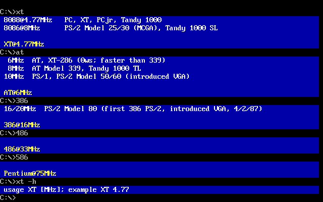

Someone had asked about setting XT speed exactly, but since DOSBox doesn't do exact, I made some simple batch files to set to system speeds based on rough measurement. Written to also accept MHz as an argument, but alas, DOSBox doesn't handle set /a, so currently statically set to xt@4.77, at@8, 386@20, 486@33, & Pentium@75. Look at the batch files to change these static settings.
Update. Added /a handling to set, patch attached, and updated the attached batch files with un-rem'ed versions. With the patch applied, you can now pass mhz as an argument, "xt 16," "386 40," "586 233," etc. Without an argument the batch files set the default.

Playing with ANSI color, and added some reference.

Reply 4 of 74, by ih8registrations
Ah, I've discovered the K "erase to the end of the line" escape sequence!:) What I've been looking for to fill the set color to the end of the line. Can add/make changes without dealing with line ends, and makes the batch files cleaner.
