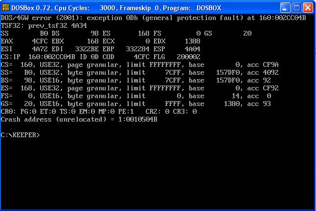

I was playing Dungeon Keeper in dosbox and after the first level the game crashed (I've included a screenshot as well). Also I had trouble installing the game, on two occasions the install wouldn't even start - just a black screen.
I have no idea what the problem might be as i played DK on my previous combuter nicely.
I have Dell Vostro 1310
http://www.notebookreview.com/default.asp?newsID=4362
in short - winXP, core 2 duo @ 2 GHz, 2 G ram
Hope someone could help

    got the following error

Hmmm. Try this command before starting the game:
core normal

seems that the problem is either related to the game cd or the dvd drive, since I tried copying the files from the cd to another folder and mounting it as drive d. I can play the game but no music since the music ran directly from the disc. oh, well 🙁

I realize this thread is old, but I'm having the same problem and I've spent SO much time googling for a working answer.
I have p3 450MHz processor 448MB RAM using win2k and I have mounted everything in dosbox according to the instructions, my disc is a copy run through alcohol 120% and mounted through dosbox as a cd drive since it won't run as a real disc and that running from hd is faster than from a disc.
I came to dosbox because the compatibility mode doesn't help anything, the main issue seems to be that the mouse or keyboard won't work when run off the windows program, I have all the patches installed as well.
So with dosbox, I get as far as loading up a level and a few seconds in, it hits that error message there. I've reinstalled it several times thinking it was wrong, but that doesn't seem to be the case. Any help would be appreciated.

Sadly, I have no idea, what your problem could be. For me, making the image of the CD solved that particular problem completely. Wish I could help.
http://www.dosbox.com/wiki/System_Requirements - it could be that your PC is just too slow for the game to be ran through dosbox, even my laptop struggles when there are those witches flying around and casting wind, not to mention when trying to run it in highres mode.

Dungeon Keeper Gold works in 2000,XP, 2003 32bit\64bit, XP 32\64bit.
ALL OS's require "Windows 95 Compatibility mode" to be applied.
Under 64bit OS's the installer will not work so you'll have to install the game on a 32bit OS and copy the files over.
Under Vista+ OS's you'll have to play the game in Vmware 6.5+ with Windows XP as a guest OS and you'll of course have to apply "Windows 95 Compatibility mode"
Your mouse\keyboard issue isn't a DK problem AFAIK. In the 10+ years I've played and tested DK I've never experienced it.
Assuming this is Dungeon Keeper Gold then all you need to do is apply Windows 95 compatibility mode to the D3D Windows shortcuts (Both DK and Deeper Dungeons) and the game will work fine.
If that doesn't work then a long time ago I had to do the below:

If you do decide to play DK in DOSBox then you should definetly be using a CUE/BIN file if you want to hear the CD Audio tracks.
I believe I remember hearing of some AI issue with the DOS ver of DK though.

If your laptop has an Nvidia card then that could probably cause the game not to work if the game works in software mode and not D3D.
If it does work in software mode but not D3D then your only solution is Vmware 6.5+

If you have a Geforce 2 then try using the drivers that originally came with the card or drivers from around the time that video card was released.
I think the fix is only needed for "keepd3d". The software mode "keeper95" shortcut should work fine without any modification.
If you can't get the software mode shortcut to work then either the game is corrupted, your video card drivers are preventing the game from working or something else in Windows is preventing it from working.
