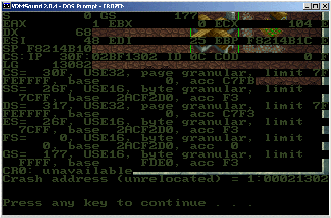

Reply 4 of 13, by Unregistered
yep, even without audio
here are the error messages I got this time...
Reply 5 of 13, by Qbix
Rank DOSBox Author
DOSBox Author
dos4gw crashed....
( i know the screen 😀 There is just too little info to little info on it to tell the reason (because of the screen being in not the default resolution)
So it's not that vdmsound crashes. it's dos4gw.
You could also try running the game without vdmsound (and without sound) (I noticed the window is still called vdmsound so..)

Reply 6 of 13, by Unregistered
Hello Nederlander 😁
Lol. it's amazing you can read through that bunch of gibberish text.
I've tried running WC1 without sound + without VDMSound but the game didn't load, just like the other dos4gw based games on Win2k. Now I want to try Dosbox but I can't seem to find it, I'm a bit overwhelmed by the tools and software present on your download page 😁 . I got the frontend thinggy, is that enough? 😖
edit: ok, I've downloaded the binary + installer and the frontend, I think that's enough but don't know how to work things out... I'm not a computer whizkid like you guys are 😁
2nd edit: if it's dog4gw that crashes, can't I get another version of this thing? 😖 if yes, where??

Reply 11 of 13, by Unregistered
from the DOS/4GW Memory Extenders thread?
edit: hmm, I used the most recent one and Wc1 doesn't crash anymore! I managed to play for 5 minutes with no problems!
