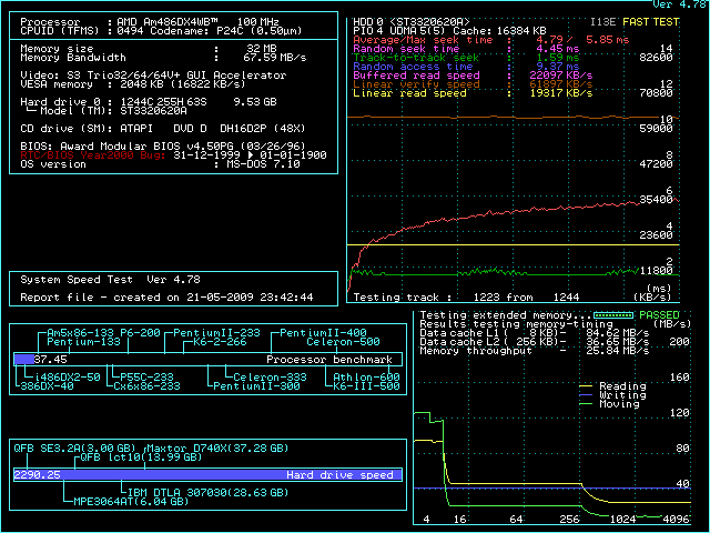

Could one (or more) of the cache chips (or TAG chip) be defective? I'm using a 486 dx2 66 CPU with writeback cache - and the mobo displays this cpu as p24d-s

Solved! I changed the Intel 486 dx2-66 cpu for an AMD 486 dx4-100 cpu. That seemed to solve the L2 cache problem. Strange. Buggy mobo BIOS perhaps? I ran speedsys, just for a laugh. Also, Doom plays fast.
