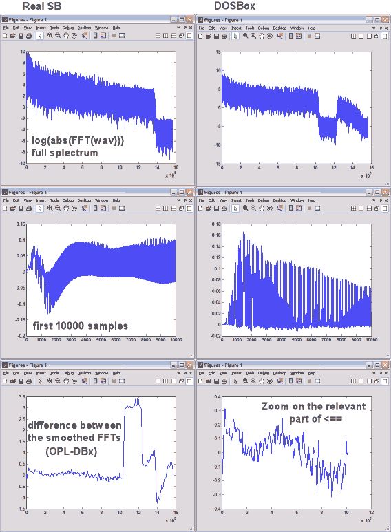

Reply 16 of 31, by Zorbid
I can hear at least two differences which don't seem to be DA-related. The introduction sounds more delicate with the real SB version and the bass sound seems louder later on.
The waveforms are quite different too, And the FFTs have som subtle differences.
The DOSBox capture has a 32000Hz sample rate, the SB one is at 44100. After bitrate conversion with ffmpg, the DOSBox wav file turned out to be 75976 samples longer (after removing the silence at the beginning of each track). I zero-padded it before applying the FFT.
I guess the high frequency cut-off is MP3 related, and that It appears as a notch on the DOSBox FFT because of the high frequencies introduced after the resampling.
There are some noticeable differences in the diff, as you can see. There are roughly more bass and less treebles on the real SB. Differences related to the length (hence frequency) difference shouldn't appear on these smoothed curves.
It could be nice to have samples at the same initial samplerate, with minimal compression added.
    17.69 KiB
    1858 views

Reply 18 of 31, by Zorbid
Actually, the graphs weren't there to support that point.
To be more precise, some instruments sound identical, some are different, and the balance between some of them is also different. I don't think that these could be DA-related.
The two "xylophone" notes that end the intro at 00:09 sound one octave lower in DOSBox. I'm sure that this isn't DA related.
The low/high frequency balance could indeed be the result of an analogic post-processing (or more simply related to the impedance of the circuits, without any intention to post process anything), but if it is the case , it would be nice if it were emulated too (you're emulating an SB, not a purely digital OPL chip, after all).
Overall, I find the original more lively.
Can you hear what I'm talking about?
I'm not complaining, btw, I'm very happy with the current state of the SB emulation. This is intended to be constructive criticism.
