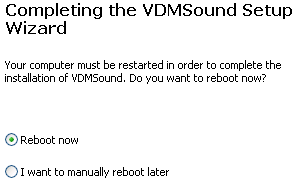

Start with installing VDMSound 2.10. Make sure you have "Administrator’s Rights" before you attempt to install. In other words, make sure you have complete access to all the features of the OS. Unless someone else has set up your access, you should have these rights by default. When you start it will give you the option to add some utilities along with VDMSound. They are handy for a number of situations, I recommend installing them (although the source code isn't needed).
When it gets to the part about rebooting....DO IT. It doesn't have to happen at that moment, but it does have to happen before you attempt to use VDMSound. Do NOT skip this step.

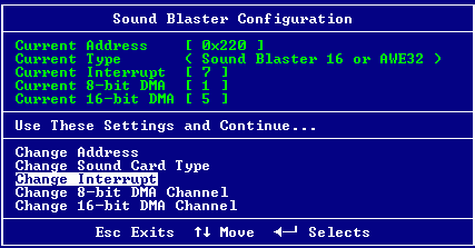

I go to the directory where the DOS program is located. Right-click on the configuration program (in this example: SETUP.EXE) and choose "Run with VDMS"
First, I choose what to use for sound effects, since the "SoundBlaster 16" option is the highest quality option (and is supported by VDMSound), I choose the "SoundBlaster 16" ("SB16" for short). Next, I choose the default settings of VDMSound (In other words, I use the setup program to match the game's sound settings to match the VDMSound settings).
The default VDMSound settings are:
Address = 0x220 (Sometimes just displayed as "220")
The type of SoundBlaster (any SoundBlaster except the AWE cards)
IRQ = 7 (Also known as the "Interrupt")
8-bit DMA = 1 (Also known as the "Low DMA", or just plain "DMA")
(especially when there is no 16-bit setting being used)
16-bit DMA = 5 (Also known as the "High DMA")
