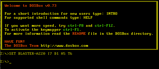

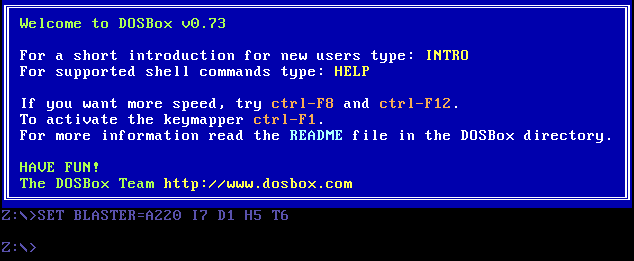

I have got this log:
Rmask=7c00,Gmask=3e0,Bmask=1f
Rmask=ff00,Gmask=ff0000,Bmask=ff000000
Dosbox started in fullscreen and the second Rmask is from when I switched back to windowed view, which is also falsely coloured (it's also falsely coloured when you start in windowed mode).
I'm attaching screenshots of both windowed and fullscreen mode.
    6.22 KiB
    2082 views
    vgaonly fullscreen mode
    6.96 KiB
    2084 views
    vgaonly windowed mode
Reply 18 of 24, by Dominus
Rank DOSBox Moderator
DOSBox Moderator
interestingly, the oficial 0.73 release for mac which colors generally works fine for me, does have the blueish prompt in fullscreen/machine=vgaonly. The windowed mode is correctly coloured.
