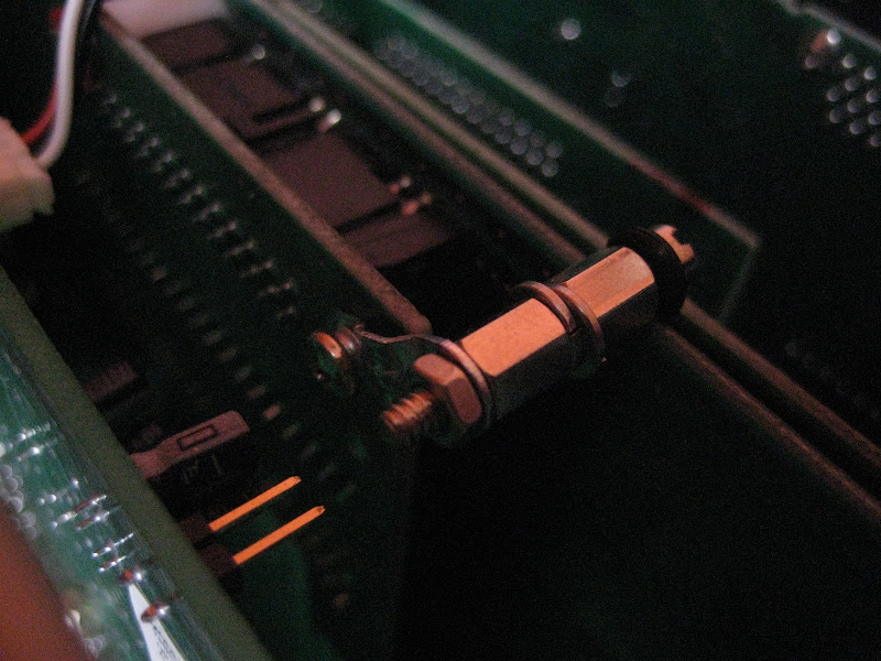

I recently got one of these cards, and I would like to use it with my DB60XG. The problem is that the two aren't fitting together very snugly. I know some of you guys have this combination, so how do I secure them properly?

The compact design of this Roland MPU 401AT card doesn't lend itself well to securely mounting a DB. I'm not sure what the solution is. I just leave the card+DB "as is". I remember testing this Roland card, and reporting my observations on Vogons -

My proposed solution to the loose header is to find some plastic hollow tube, cut it down to the appropriate size and use it as a stand-off which is secured by a thin bolt which passes through the center of it.

In other news, I solved about 90% of the loose header problem I was having. It involves using two 1/2" nylon spacers, and two 3/4" bolts.

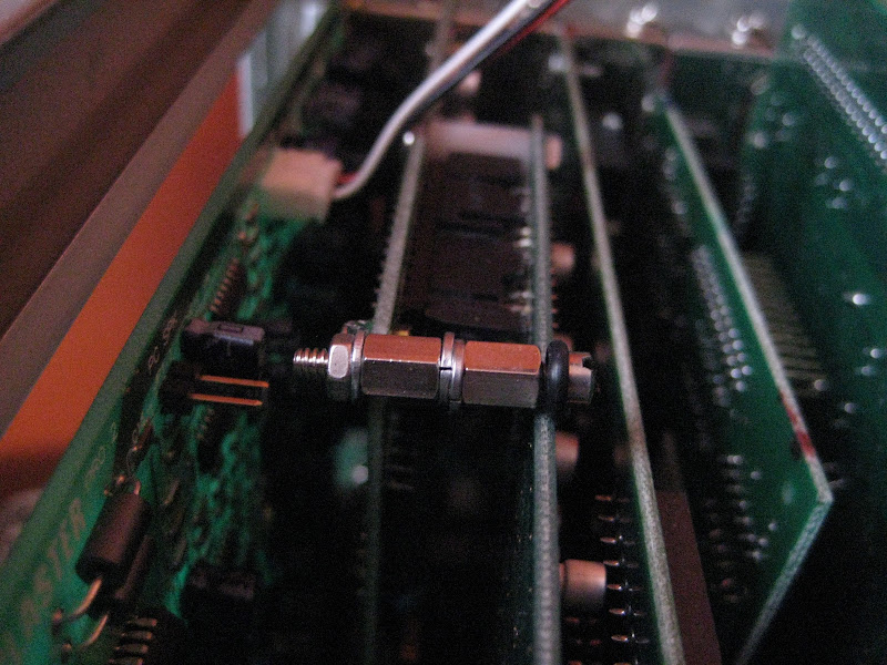

Reply 11 of 11, by Anonymous Coward
