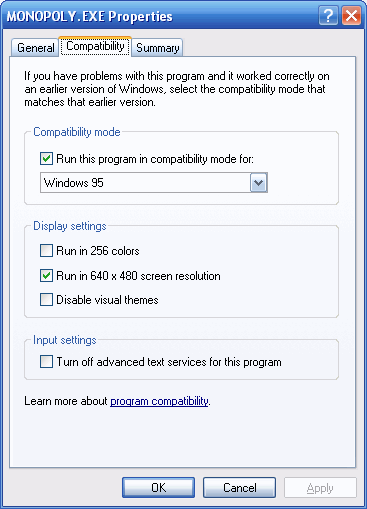

Just a-wondering why you used DOSBox+W3x to install and play Monopoly? I'm assuming that you are refering to the old Monopoly CD by Westwood?
If so, Westwood's Monopoly CDROM runs just fine under Windows XP using XP's 'compatability mode' feature (see attached pic) 😀 Not sure about running the game under Vista or W7 though.
(edit) Oh, and I'm running Monopoly CDROM with the v1.3 upgrade patch applied (Google for monpch13.exe or monpch13.zip)... not sure if it will run under XP without it.
