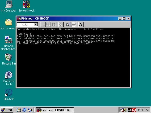

Edit Incidentally I tried running it in Windows again. Unlike last time I barely got five minutes of play before it crashed, but this time it didn't reboot my computer but gave me an error message.
Anyone know what to make of this? (And yes, I'm running it from the actual, store-bought CD, not from a copy or an ISO)
