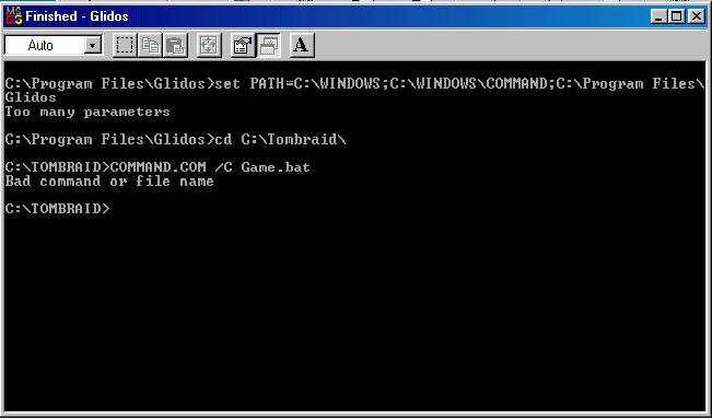

Reply 4 of 15, by Mixxy
ok so I've set dos emulation to windows - this is the result. I can't edit glidos.bat as this is created on the fly by glidos as is game.bat - so they cant be changed to point things in the right direction ... any ideas? or am I barking up the wrong tree here?
    29.37 KiB
    3903 views
Reply 5 of 15, by Qbix
Rank DOSBox Author
DOSBox Author
try installing GLIDOS in C:\Glidos.
Looks like PATH gets confused by the spaces in C:\Program Files
Water flows down the stream
Reply 8 of 15, by Mixxy
Now we're getting somewhere. I reinstalled glidos 1.47 in c:\Glidos and got tr running using windows emulation and openGL. I can't get it to run in Direct3D as glidos reports that it can't run psVoodoo. With openGL the textures are moving (or sliding) as lara moves. I've tried every combination of display settings but it doesn't change the way the textures behave. I've also tried using a texture pack, with the same results.
