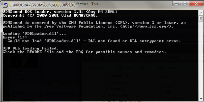

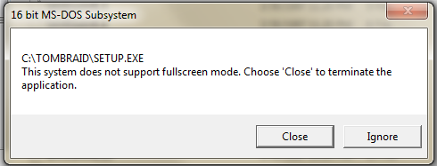

Reply 13 of 14, by Antonijadis
Can you be more specified. Without Glidos I always get this error.
