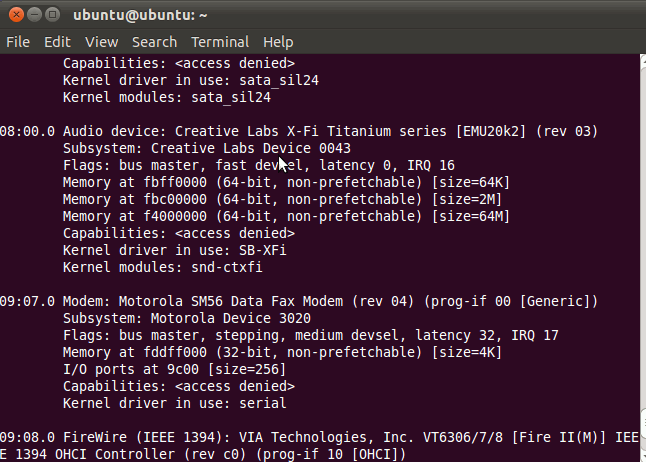

The drivers for Linux, at least for my card (X-Fi Titanium Fatality Championship) had a slight mistake in the drivers for PCI-E cards...fixing that might help, the mistake lies in ctdrv.h.
The line #define PCI_SUBSYS_CREATIVE_SB0880 0x0041 is wrong (in the last official drivers I tried, some 2008 release)
You need to lspci -v and look for:
Subsystem: Creative Labs Device 004x
Where the x is a number, usually 2 or 3 instead of 1
And change the line above accordingly, it might help you...or it might not.

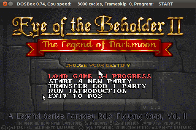

*Update* I just tested it with a 10.10 and got no screeching with the default Ubuntu drivers (see screenshots).
