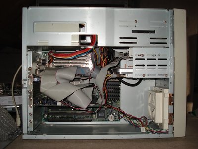

Reply 1 of 3349, by Old Thrashbarg
Alright, well, here's one of mine. It's a very rare occurrence for my digicam to work, so it'll probably be awhile before I get pics of any of my other systems. Most of them consist of crap plugged together on top of cardboard boxes anyway, so it's not much to look at.
Anyhow, this is my Slot-A box, 800mhz Athlon Classic, Asus K7V, 384MB PC133 CAS2, Voodoo5 5500 AGP, SBLive, 30GB Maxtor, TDK CD-RW, Zip, Teac FD55GFR, plus a NIC and USB2.0 card. Case is an old Antec KS288, OS is 98SE.

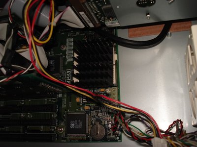

I seem to have won the battle with my camera for now, so here are a couple more shots, this time of my 386 system.
Specs are:
Chaintech 340SCD motherboard
AMD 386DX-40, 64K cache, Cyrix 87DLC copro
4x4MB 60ns SIMMS (yes, 60ns 30 pin SIMMS)
540MB DEC/Seagate SCSI HD
8X (?) SCSI CDROM, leftover from upgrading one of my Mac clones
Toshiba 1.2MB 5.25" floppy drive, and a random 1.44MB 3.5" drive
200W "Pro-Lin" PSU, generic case
Top to bottom, cards are:
-random Hong-Kongian I/O card
-ATi Graphics Ultra
-Realtek NIC
-Adaptec AHA-1542CF fast SCSI card
-Shuttle HOT-223 sound card... interesting in that it has two daughterboard headers and a real OPL3. I haven't had a chance to play with it much yet, though.

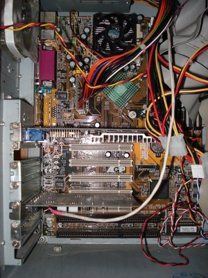

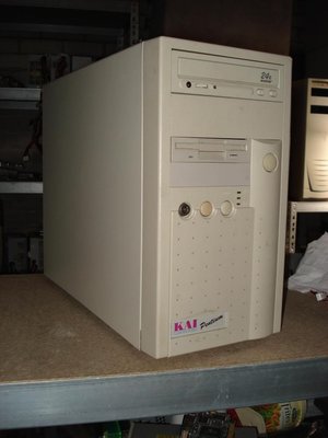

I've changed the configuration of this system again to make it more era specific. I formerly had a 386/486 VLB hybrid board in this thing, but now I'm back to a pure 386 OPTi 495SX board (with writeback cache). I want to stick the IBM DLC upgrade module back in this thing later too, but I need a CPU socket riser so it will fit.
-AMD 386DX-40, Cyrix Fasmath 83D87 40MHz
-256kb 15ns SRAM
-32MB 60ns Parity 30pin
-20GB Seagate Barracuda SCSI HDD
-Adaptec 1540C ISA SCSI controller
-Tseng ET4000W32i 2MB DRAM Graphics Adapter
-3com 3c509B ISA 10MBps NIC
-Creative Labs CT1770 SB16 ASP w/WaveBlaster II
-Panasonic 1.44mb/IBM 1.2mb floppy drives
I removed the CD-ROM drive and replaced it with a grey plastic HDD drive panel with a green LED.
CPU and FPU different than shown here, and battery removed.

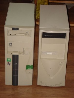

As I was taking some pics for DonutKing, I took the opportunity to take some pics of the 2 retro rigs I used to play Unreal, so here they are 😉
The attachment DSC00504.jpg is no longer available
The left box is my Super 7 Glide rig and the right one is my s370 Glide rig

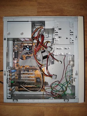

The s370 Glide rig:
The attachment DSC00507.jpg is no longer available
FSP-made PSU 250W
Chaintech ??? i400BX Socket 370
Celeron 800 (yep...could've just put a Pentium 3 in there butteh...I wanted a Celeron hehe 😜)
256ish MB SDRAM PC-100 cl2 or PC-133 used as PC-100 cl2
AGP Voodoo3 3000
Soundcard can't remember if this one had the Vortex or the Creative
Some random cdrom burner or drive and another plain ol' boooring "a million a bucket" floppy drive
Harddrive probably 10 to 20Gigs
This rig was build after my 1st Glide retro rig.
As I had chosen the Voodoo2 in my Super 7 rig, I still was eager to try out a dedicated Voodoo 3 rig of my own.
I decided that a P3-1000 was a little bit overpowered for a Voodoo3 so I opted to try an Intel BX system.
As I prefer Socket 370 over Slot 1 I ended up using this i440BX Chaintech motherboard.
As I had no speedy 100Mhz fsb Coppermines at that time and underclocking one of my then few P3-1000's to a mere 750Mhz, I decided that I might as well put my Celeron 800 in there.
Another reason for me to stick with the 800Mhz Celeron is because I encountered a slight problem while mounting it's cooler: There are so many caps directly around the socket that it's impossible to mount anything larger then a Socket 7 sized cooler. I did try a smaller aluminium cooler but after a little while the heatsink became a little bit too hot for my taste.
Hence I went with the Celeron 800 (slower ones are 66Mhz fsb and I wanted 100Mhz fsb) and my only smallish copper cooler you see in the pic. I might have replaced the original Coolermaster fan with another Coolermaster fan to make it a bit more quiet.
However!...even though the little copper cooler cooled it much better, it's clip was blocking the memory slots and after a while I got tired of having to unmount+remount the cooler everytime I wanted to switch memory around. So I put the aluminium cooler back and mounted a neat looking LED fan which shines in 3 different colors yay! And it did fix the overheating problem well enough. (edit:the LED fan is actually an 8cm case fan. Thought I should point that out :endedit)
The 800Mhz Celeron is somewhat special as it is the very first Celeron to make use of the 100Mhz fsb. All previous Celerons were limited to a mere 66Mhz fsb which was fine for the PPGA Celerons, but made the first lot of Coppermine Celerons woefully underpowered compared to it's Coppermine brother (I always try to avoid the Celeron 566-766 ones).
That, and I actually wanted to use a Coppermine Celeron (I had already used a couple P3 Coppermines before and wanted to try out something new 😉 )
I used a different soundcard in this rig as I wanted to play through the campaign with a sound solution that was totally different from that of my other Glide rig.
Of course I installed ME on this computer also. XP seemed a bit too new for this one.
The case is a very nice one. Sturdy and good looking for an ordinary beige case.
No sharp edges on the inside, it was probably made by a quality manufacturer.
The only thing I dislike about the case is it's miniholes on the back for using the 8cm case fan, but other then that, I'm very pleased to own 2 of these cases 😀
I've played through the entire Unreal campaign again, only this time in hard.
Again, not a single crash or other ugly problems.

I see you went with the typical mid-'90s "meh, screw it" style wire management, too. 😁
That's a rather poor design for the vent holes on the front of that second case... at first glance, I thought that was mildew or something.

Lol! Yup, couldn't be bothered using tie ribs, but at least I kinda pushed the cables away from the HSF 😁
And yes, the vent holes are rather crappy though the back vent hole is a bit less crappy. It's the only thing I don't like about this case though, it's perfectly fine otherwise 😀
