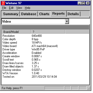

I'm testing this card on an Asus VL/I-486SV2GX4 revision 2.1 mobo. It has an AMD DX4 120 MHz (write back) CPU in it, with 1 stick of 16MB FPM. For all of these tests, I have run them using the mobo's FSB setting of 40.

WinTune 2.0 for Windows 3.x, video score - running at 40 FSB.
WinTune 97 for Windows 95, video score - running at 40 FSB.
