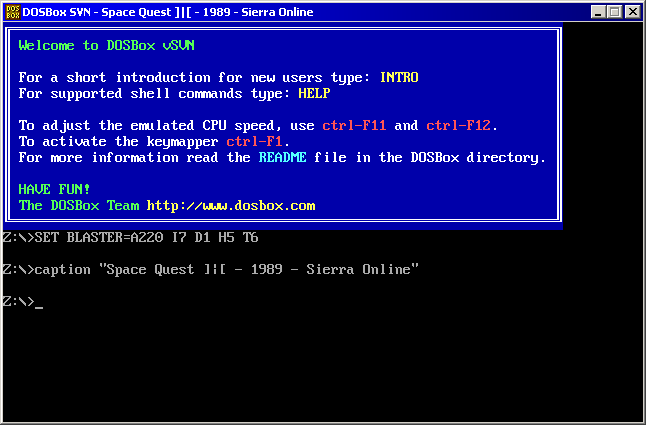

I was wondering if it is possible to configure the title bar to display specific text. Example could be, instead of:
DOSBox 0.74, Cpu speed: 3000 cycles, Frameskip 0, Program: SIERRA
Display:
King's Quest I: Quest for the Crown
Once I get a program setup to run the way I like, their isn't much need to see all of the other information. If this can be set in the config, updated by a patch, or even added to as a feature request, I think it would enhance the overall feel of DOSBox.

Here's a patch for a user caption. It sort of follows the "Application - Document" approach seen in Windows apps, but easy enough to change; and the pause status is still added to the end. Also made the caption changeable at runtime for extra flexibility; change it to nothing (caption=) to reset to normal status info.
Kinda doubt the devs will incorporate the feature, but enjoy the patch, anyway. 😀

How about reversing it to "Document - Application". That way if you have more than one DOSBox instance you can tell which is which on the taskbar at a glance. Firefox and some other applications do this. And the window would still be branded with DOSBox.
I kept DOSBox "branded" at the beginning for consistency, and also because (playing devil's advocate) one could use a very long caption to cause the DOSBox name to be clipped off the end of the title bar. However, it is trivial to change the sprintf() to whatever.
An additional benefit to making a runtime init routine for options in the SDL section of the config: adding the fullscreen setting.
 void GUI_Init(Section * sec) {
Section_prop * section=static_cast<Section_prop *>(sec);
sdl.desktop.caption=section->Get_string("caption");
+ bool fullscreen=section->Get_bool("fullscreen");
+ if (fullscreen!=sdl.desktop.fullscreen) GFX_SwitchFullScreen();
With this it's possible to switch in and out of fullscreen from the command line, which could be useful in some ways, like in batch files. I think it's possible to do something similar with config -r (restart), but that wouldn't work as well in the context of a batch file.

If it is really a concern to keep the window branded, could it be done in a way to limit the number of characters that can be used, so that it is the custom title that still gets clipped and the last few would be reserved for DOSBox? In other words,
"Really Long Title Name Here... - DOSBox SVN".
Reply 7 of 7, by ripsaw8080
Rank DOSBox Author
DOSBox Author
Well, it's complicated to do calculations on what will "fit" in the title bar, because the font is configurable and usually proportional. However, if you only set a limit on the number of characters allowed in the user caption to a "safe" amount that generally precludes pushing the DOSBox name and version off the title bar, that's easy enough to do.
