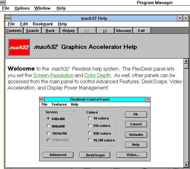

Using Windows 3
I can't get my LCD to display @ 1280x1024, without it going in to a non LCD friendly refresh rate, and consequently displaying a blank screen.

The info says that the chip type is Mach32_Rev3, and the DAC type is ATI68830. Presumably, if you put a RAMDAC chip in to the empty brown socket, the DAC type would be different - and better. In what way?
