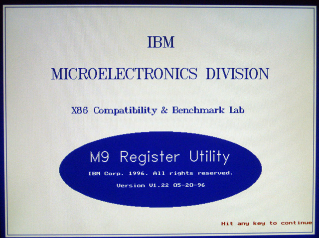

BIT ENABLING PROGRAMS
Since most motherboard manufacturers did not enable the special features of the Cyrix 5x86 in the BIOS, bit enabling software programs were generally required, however one manufacturer (PC Chips M919) allowed for two such features to be enabled in the BIOS (LINBRST and LSSER). While it is not well documented why more companies didn’t follow suit, is likely due to time constraints and the fact that the 486 was considered a low-end, low-priority item by mid-1996. Unfortunately, even the latest BIOS update for the Biostar MB8433 UUD, dated May 1996, does not include a user adjustable enabler for Cyrix features.
While the IBM utility uses a GUI as a means to enable the special features, the Peter Moss utility uses on/off flags to enable features, for example, to enable BTB_EN and RSTK_EN type, 5x86.exe /BTB_EN=on /RSTK_EN=on. The Evergreen utility is a little more cumbersome to use since you need to type in HEX values for an entire register (8 bits, or features, per register). For example, for the performance control register (PCR0), if you only want LOOP and RSTK enabled (and the other bits of this register disabled), you’d need to type, ET586.exe /PCR0=5, where 5 is hexadecimal digit. From the above chart, 00000101 in binary representation is equal to 5 in hexadecimal. Even more confusing is that the Windows NT/2000 driver from Evergreen Technologies requires its units to be in decimal. It just so happens that, in this case, 5 in hexadecimal is also 5 in decimal, though this is not always the case. Screenshots of the various bit enabler programs are shown in Appendix 1.

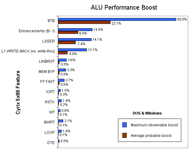

From the graph shown above, it is clear that BTB had the largest impact for ALU-focused processes, with a 22% boost. BTB, or branch prediction, on a Cyrix 5x86 is generally not considered a stable setting in Windows except possibly with Stepping 1, Revision 3 CPUs. To get BTB working on Stepping 1, Revision 3 CPUs, it is necessary to disable LOOP, BWRT, and possibly RSTK. The CPU used in this study was Stepping 0, Revision 5. It was possible to run the noted Windows benchmark tests with LOOP, BWRT, and RSTK disabled, however the only way to boot into Windows was to first boot into DOS, then type win at the command console to enter Windows. BTB appears stable in DOS with both revisions of the CPU. To date, no other CPU revisions have been encountered. The Cyrix 5x86-80 and 5x86-100 came in Stepping 1, Revision 3 editions, whereas Stepping 0, Revision 5 CPUs came in 100, 120, and 133 MHz flavours.
It was recently discovered that Windows NT4/98SE/2000 all initially appear usable with a Stepping 0, Revision 5 CPU and all Cyrix features enabled (including BTB) except for LOOP, RSTK, BWRT, and DTE. Stability, however, had the tendency to decrease as the CPU was run longer (and began to heat up). This effect may be more of a consequence of running the CPU overclocked and above thermal spec for core voltage than with a broken feature. Some Cyrix features may be more frequency and/or thermal sensitive than others.
Referring to Appendix 6, we see that BTB did not have such a magnificent impact for DOS-only ALU tests; in DOS, performance boost dropped to only 5%. An interesting point to note from the DOS-only ALU chart is that LOOP yielded a performance gain only when used in combination with BTB, thereby bumping the results up another 1%. Also surprising was that RSTK seemed to have no effect on its own accord. Unfortunately, LOOP and BTB together were not very stable. They may only work together in 16-bit mode since Windows would not boot with this setting and 3Dbench, Doom, Pcpbench, and Quake wouldn’t run. It may be that BTB and LOOP work well together with Stepping 1, Revision 3 CPUs, however this configuration wasn’t been tested.
Next in line for performance was LSSER at 7.4%. It was previously thought that LSSER needed to be disabled (set to 1) for motherboards which contained in-use PCI slots, however the author has had LSSER enabled (set to 0) for years with 3 filled PCI slots and hasn’t had issues. From personal experience, the Biostar MB8433-UUD and PC Chips M919 both functioned with LSSER enabled.
Surprisingly, setting the L1 cache scheme to write-through mode instead of write-back only indicated a 4% improvement for ALU performance, though some tests showed as much as a 12% improvement. It should be noted that all other enhancements were still enabled. If write-back L1 cache is disabled in the BIOS instead of through software, it may not be possible to fully enable other Cyrix special features (although they may appear to be enabled).
LINBRST, which is noted in the Cyrix literature as improving performance, only helped by an average of 0.5%. Your motherboard’s chipset must support linear burst write cycles to enable this feature, otherwise your system will crash upon enabling it. While both the Biostar and M919 support LINBRST, there seemed to be no real performance boost, unless perhaps this feature cannot be disabled in software once the BIOS has enabled it. If this is the case, the only way to test for it would be to use a comparable motherboard which does not support this LINBRST, such as the Shuttle HOT-433. Only CPUMark32 in Windows caught the 4% improvement with LINBRST.
MEM BYP had the same ALU fate as LINBRST, with only a 0.5% improvement, however some tests weighed it in at 3.3%. FP FAST also didn’t do much for ALU operations. Surprising is that IORT, which was set to 128 clock cycle delays, didn’t seem to drop the performance much. It may be that the BIOS took over this setting without the possibility for intervention, however setting IORT to 128 clock cycles did drop the frame rate in DOOM by 5 fps.
WT, when enabled, sets only the memory region from 640 KB – 1000 KB into write-through mode (as opposed to write-back mode). When set to 0, you get write-back mode in this small region of memory, though doing so causes Quake not to run, and will yield an extra 2 fps in Doom. DTE and BWRT also had little to no effect on performance.
To summarise this section, if you can get BTB working, use it with a smile. LSSER is next in line for performance boost. Don’t be too bummed if you cannot get the other features working, though if you can, adding up all the effects of the weak performers adds another 1% of boost on top of LSSER. If all stable/optimal enhancements are enabled, you should see a 13.5% ALU performance boost (B – I), though some applications may see up to a 50% boost. If you can get BTB working, you may see another 8.5% of ALU boost. From the Ultimate 486 Benchmark Comparison, the combined total boost of these Cyrix 5x86 register features weighs the ALU of a Cyrix 5x86-133 in at about the level of an AMD X5-160, or a Pentium 100 with pipeline burst cache enabled. Not too shabby for a low-cost, low-power 486.

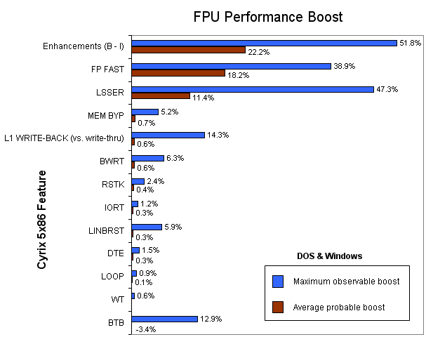

The floating-point units (FPU), or co-processors, of microprocessors are used extensively in high-performance games, simulation software, mp3 conversion, modeling, etc, so depending on your intended use of the processor, these results may be more (or less) important than the ALU results. Starting with BTB, we see that, on average, enabling this feature decreased ALU performance, but only in Windows. In DOS, it enhanced performance by about 2%. This performance drop wasn’t an isolated case, since WinTune98, Sandra99, and PassMark all indicated a drop in performance.

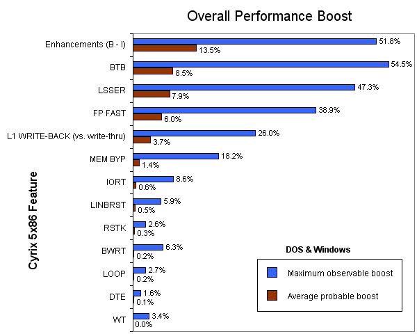

The clear leader for FPU performance enhancement was FP FAST, which boosted the average FPU test results by 18%. Next in line was LSSER with 11.4%. MEM BYP helped by as much as 1%, while all other features had a relatively low average probable boost. It may be naive to entirely dismiss the other features since some tests indicated significant improvement. MEM BYP, BWRT, and LINBRST all had about a 5% improvement for the best case test. Even BTB, whose average is negative, improved performance by 13% in some tests.
The entire ensemble of stable/optimal features improved FPU performance by about 22%, and from the Ultimate 486 Benchmark Comparison, a Cyrix 5x86-133 rates in at about a Pentium 90. Even an AMD X5 overclocked to 200 MHz was about 4 Pentium ratings (PR points) below the Cyrix 5x86-133 in FPU-related tasks.
RESULTS - OVERALL
The overall performance graph encompasses a much larger number of tests than either the ALU- or FPU-specific graphs so the overall results are far more encompassing. The above graph can speak largely for itself. In line with the conclusions made in the ALU and FPU sections, BTB, LSSER, FP FAST, and perhaps MEM BYP are the most important of all the Cyrix 5x86’s special features. The Symantec (Norton) Sysinfo benchmark program really seemed to think that MEM BYP hot stuff; it boosted the results of this test by 18%, however the average probable boost was a mere 1.4%
Considering that LSSER had a large impact on both ALU and FPU operations, it may be considered the most important Cyrix feature to enable. While BTB looks like a big contributor overall, it had less than half the performance of LSSER for DOS-only activities (not to mention its poor FPU performance). Rated second is a toss-up between BTB and FP FAST; it is hard to look past the whopping 18% improvement offered by FP FAST. In fourth place is MEM BYP, followed perhaps by LINBRST and BWRT.
The write-back caching scheme of the Cyrix 5x86 is charted mainly out of curiosity and is not a feature specific to Cyrix 5x86 processors. Both AMD and Intel employed write-back caching in their later 486 CPU revisions.
Looking now at the raw DOS gaming scores, LSSER and FP FAST showed the most improvement in Quake, gaining about 1.3 fps each, while BTB only improved Quake by 0.3 fps. With all stable Cyrix features (B – I) considered, we see about a 2.6 fps gain in Quake and about 2 fps gain in Doom. For 3Dbench, all stable Cyrix features (B – I) improved the score by 3%, whereas BTB alone improved the score by 4%.
