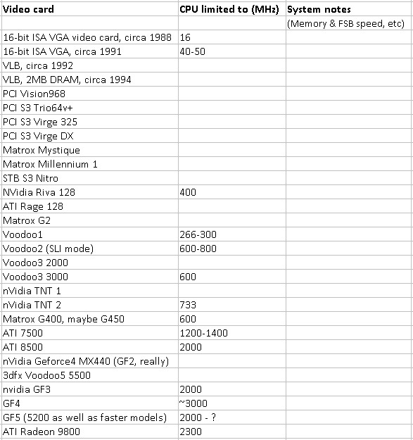

Thanks a lot. I thought about making a table with this data. How about this? I can edit it, when new data is suggested. When all of the rows in the table are complete, I can then resort it, based on the CPU speed. That way, you can get a general idea of how powerful these cards are, in relation to each other.
Edit 1: I have added a 3rd column, "System notes"
Just to clarify something here please. The idea is that I get to use all of my different mobos, from circa '88 to 2000+. Say I am working on a socket 7 mobo. What video card would be best suited for it? If a Voodoo3 can perform faster in a faster socket mobo (which it can, based on the data in the above table), then I wouldn't choose that video card for the socket 7 mobo. But say a Trio64V+ can't run any faster than a mobo using a 200MHz CPU, then I'd put a Trio64V+ in a socket 7 mobo, and use it with a Pentium 200 CPU.
I'm trying to think about what cards go in what boards. For a 16-bit ISA VGA card circa 1991, I now realise that I'm looking to put this card in a 486 board, and I need not bother looking for any CPU faster than about 40-50MHz. I can be satisfied that if I were to put in a faster CPU such as a DX2/66 CPU, this video card wouldn't give me faster frame rates, and so this CPU upgrade is not necessary.

If you do a big testing / benchmarking marathon, I would definitely do charts, showing how the performance improves and then trails off. Would make for a very interesting study...
Having said that, it also depends heaps on the benchmark. One could show a graphics limitation (a faster CPU doesn't improve the score) like something with heaps of AA, another one a CPU limitation (score keeps going up with a faster CPU), like a 640 x 480 and very basic benchmark.
Reply 16 of 20, by elfuego
Guys, its not always CPU limitation only. Tbred and Bartons behave completely off the charts on different platforms - just compare VIA KT133A (great SDRAM chipset) vs NFORCE2 ultra. Doing 3dmark 2001 benchmark on Radeon 8500 on the same CPU (~2GHz) but different boards/memory is cca 8.7k marks vs 13k marks. Same improvement can be detected in Morrowind, I know because I tested this myself back in those days.
So I propose to include at least memory configuration too in the table.

Thanks a lot for the excellent suggestions. I have added a 3rd column to the table, called "System notes". If this can be improved, please let me know and I'll change it again. It's easy to do. Thanks.
